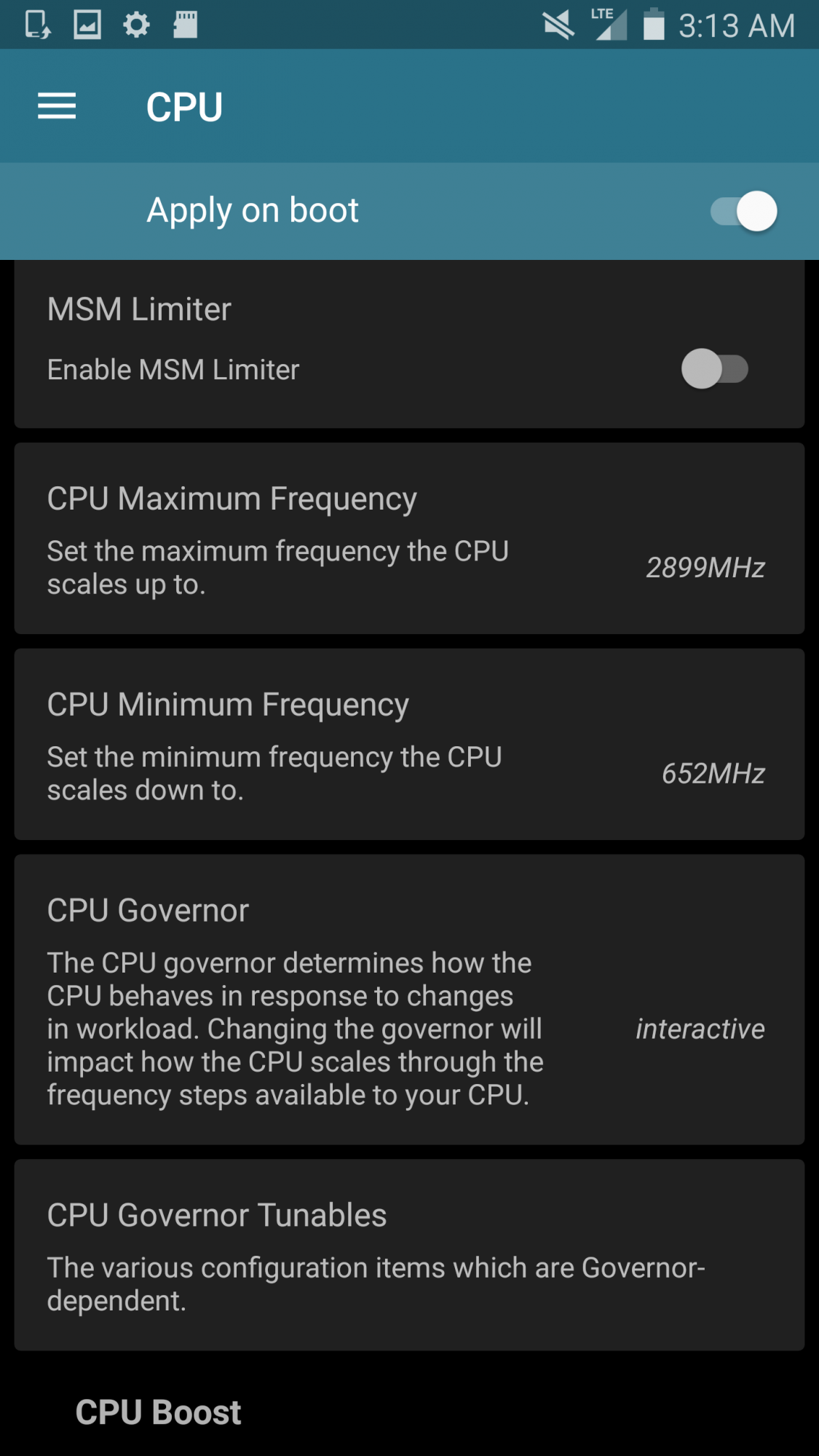

I have Note 4 n910p and I flashed a permissive custom kernel by freeza with Zero Lemmon support. Try looking threw the XDA threads to find one for your specific device.
Before I flashed the zero lemmon kernel. I used the method above and it work for me. I dout you'll see it in system battery states if thst what your looking for but I see it in kernel Aditior app.

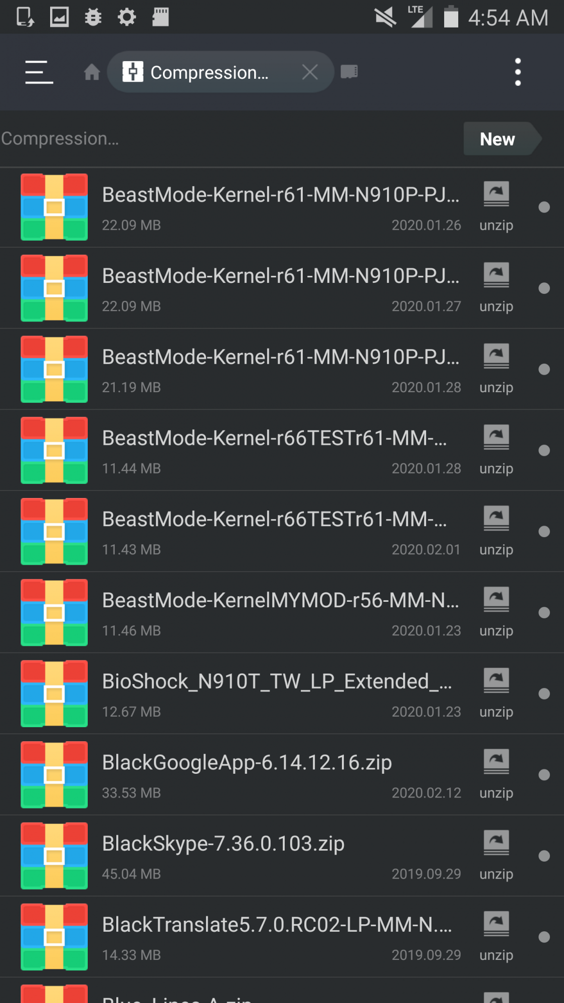

Anyway, I was uncertain but I was willing to take the risk. I decided to use the app in the link below
https://play.google.com/store/apps/details?id=ru.zdevs.zarchiver
I downloaded both kernels and replaced the r61 boot.img with the r56(overclooked) boot.img. All folders and files of the r61 zeroleemon kernel but moded with r56 boot.img. I put it on the root of my external sd and flashed it.
Success, got my cake and ate it to. :)
