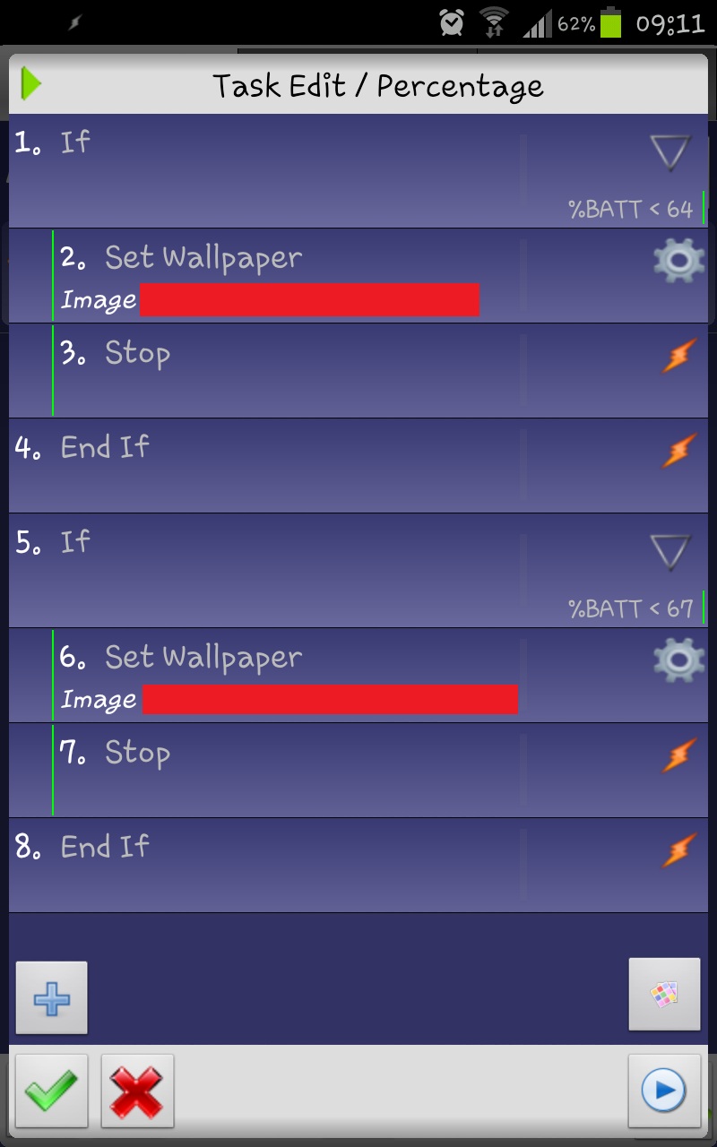

Do you mean something like the attachment I added? Wouldn't that cause a problem too, as something which is below 64% would also be below 67%?
EDIT: I'm stupid, I know what you meant. Don't mind this anymore.
I don't know how to add multiple pictures to the If %BATT<11 statement. I assume you said "picture01to10" in case I have 100 images for each percent of the battery? I'm not sure yet, maybe I will only have one each 5% of the battery, or something like that.

I could be entirely wrong, but even with that the last thing tasker reads is for a full battery.
As computers read code the same way we do, top left to bottom right, you'd need to reverse the above values to make the wallpaper change as the battery depletes. That way as the code is read, it'll get to 67% and change the wallpaper, then read on and ignore the rest because the battery level is a greater value than the next lowest "if statement
It is an attempt to implement &#8220;select case&#8221; logic using if/then blocks.
Once an &#8220;if&#8221; condition is satisfied and associated wallpaper is set, the &#8220;stop&#8221; statement terminates the profile&#8217;s task without any further execution. So if battery level were 67%, then none of the if/then conditions are satisfied the until the <71% check, which will execute, set the wallpaper to the item which would be labeled 61-70, and then stop (the <81% check and later checks will not be executed).
If the block structure with stops bothers you, you could change each "if" statement to include two conditions: one in the normal "if" condition and the 2nd by checking the "if" box in the set wallpaper action dialogue box. With two conditions per "if", you can specify the top and bottom of a range. 10 such statements could define 10 non-overlapping ranges 1-10, 11-20, 21-30 etc
Yet another approach, divide the battery level by 10 and truncate the result using the floor command. Then you can check whether the result matches 0, 1, 2, 3, 4... etc.
As usual, many ways to skin a cat. I'm sure others could come up with more.
