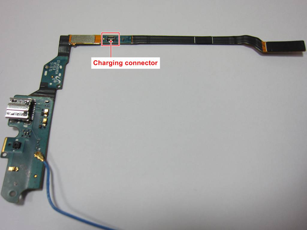

If you changed the charging port - this unit is what you renewed? The BLUE wire in lower left is the antenna and this is where a lack of signal problem can be caused.
There are numerous spring contacts on the boards as 3 are visible in this view. If the cover was not fully clipped into place during assembly, yes you would entertain problems with bad contacts. Nice to know you've sorted it all out.
Yes, I replaced that port.
Yes, it is an antenna, there is another on the other side, but I have read it is the WIFI antenna, not the cell signal antenna.

There may be many antennas in the S4 Galaxy i9505 which are hidden inside the plastic frames but I still refer you to my first reply where from my own experience If the frame sections are not assembled correctly (fulled clipped together) the spring contacts may not connect properly. Hence your problem.
I have seen S4's which owners have taken apart and when they assembled the phone - there were gaps around the front and middle frames (not aligned and clipped in place). I have taken the phone apart and correctly assembled it and it worked!
