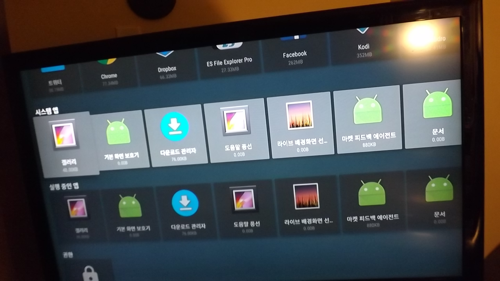

I am attaching 3 on screen pictures of this Android.Please help me.Do I need a new software?.From where can I get new English language software for this receiver,please.Kindly help me please.

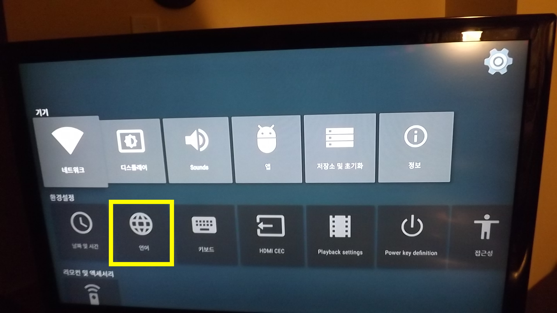

First problem, that's not Chinese, it's Korean. I can read Chinese, I can't read Korean. Also it's a UI I've never seen before. You bought this Android box from China? Can you see anyway of factory resetting it, as possibly it's got into some funky mode and selected Korean as the UI language for some reason, or could be a plot by Kim Jong-un?
According to Baidu Translate 언어 입력기 is Korean for "Language and input method".
EDIT
What's in that globe icon? Because that looks like 언어, which checks out as Korean for "Language".
I followed you.There was some option blocking .I tried globe(Korean) then next,I tried all options one by one and got full language aoption.Iset to English.rebooted and all it is working fine.
