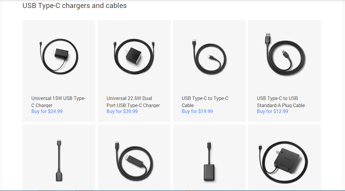

There are chargers in the Google store that are type-C, so I took that as a sign of them being "sanctioned" for use. Unfortunately, there are no car chargers listed here.
