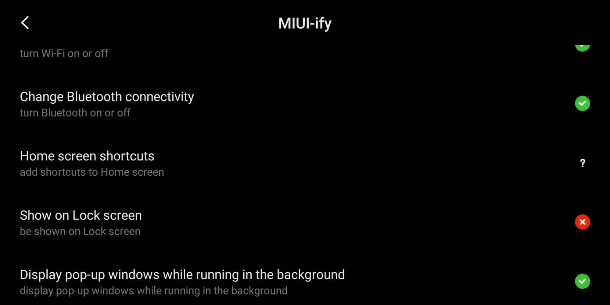

Thanks, but I found the solution myself.
The setting 'Display popup windows while running in the background' is new since MIUI 11 and is turned OFF by default.
This results in non-working widgets of some apps and also some tiles of MIUIfy were not working anymore.
Even the K9 mail widget was not working.
The Taskbar app (a very useful and lightweight quick launcher, which is not an actual launcher, but a popping up list of favorite apps) was also stuck.
I enabled 'pop up while running in the background' of these apps and the problem was fixed.
Hi. I have the same problem and I don't understand how you solved it. I lookd for the option in Settings and couldn't find it, I also downloaded the MIUI-ify app you show in the screenshot, but couldn't find that option.
