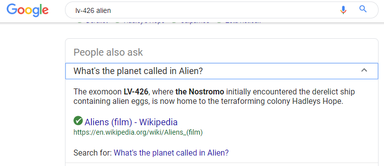

Next. What's with "LV-426" and the Alien alien? Got it... You realize, I saw the original Alien movie when it opened! (...wait a minute... "Alien", not "Aliens". I saw *both* when they opened. I guess LV-426 didn't show up until the second movie. The first movie was far, far, far better than the second one.)
