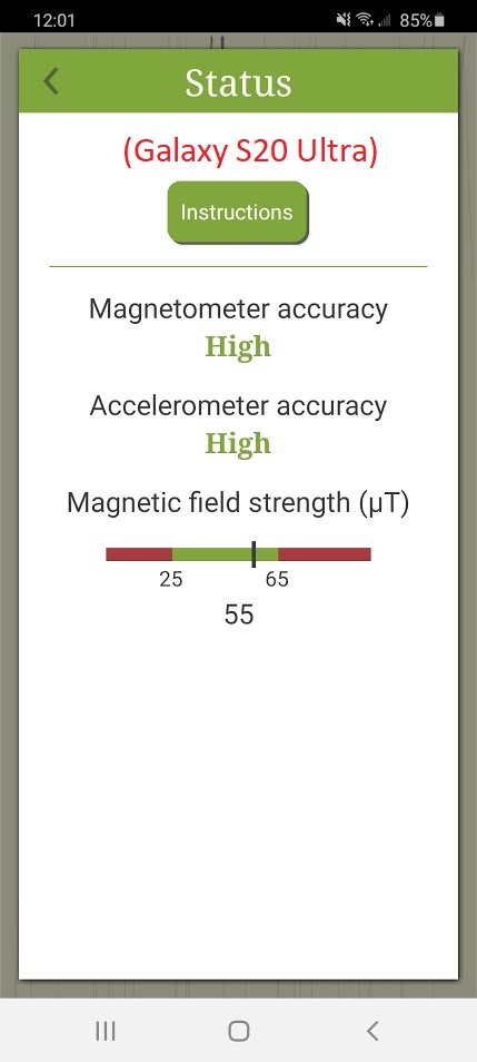

I've attached screen shots of an App called "Accurate Compass" because it allows me to check the status of the magnetometer. When it stops working, it just completely goes unresponsive. The first image shows it working perfectly well immediately after the phone has restarted. The second image occurs after the phone has sat idle for a certain amount of time (I don't know exactly how long it takes to stop working, but I am trying to test this).
