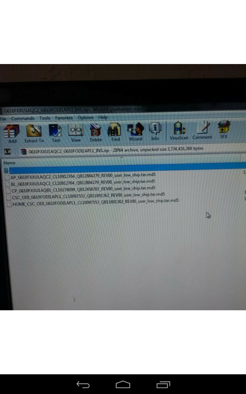

It had five files I will upload the pic of the five files and plz tell me if I should use all the five or just the ap file

can you see the pic and plz help me asap
