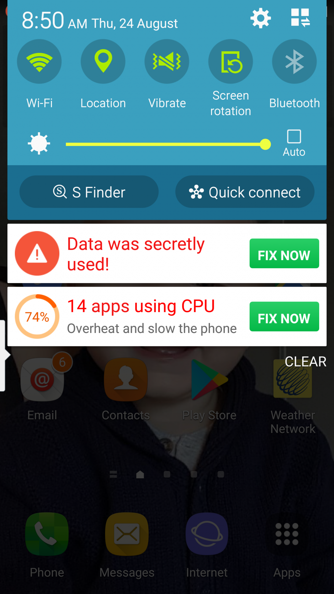

Why does my s4 send me a message data being secretly used it just started happening about a month ago I have had DU speed booster and cache cleaner on my phone for about a 1 1/2 years and it just started sending me that message and I know it's the DU speed booster because when I link on it that app comes up. What does that mean?
Hi. I am getting the same message on my note 4 all of a sudden along with overheat warning. I can't seem to find DU Speed Booster on my phone though!?!
Long press on the notification and it should tell you what app is producing the notification.
Thank you Hadron =). I have cleared all messages, deleted a couple of apps that I have never used, and cleared my system cache. If it ever shows again, I will try your suggestion. I appreciate the response!
