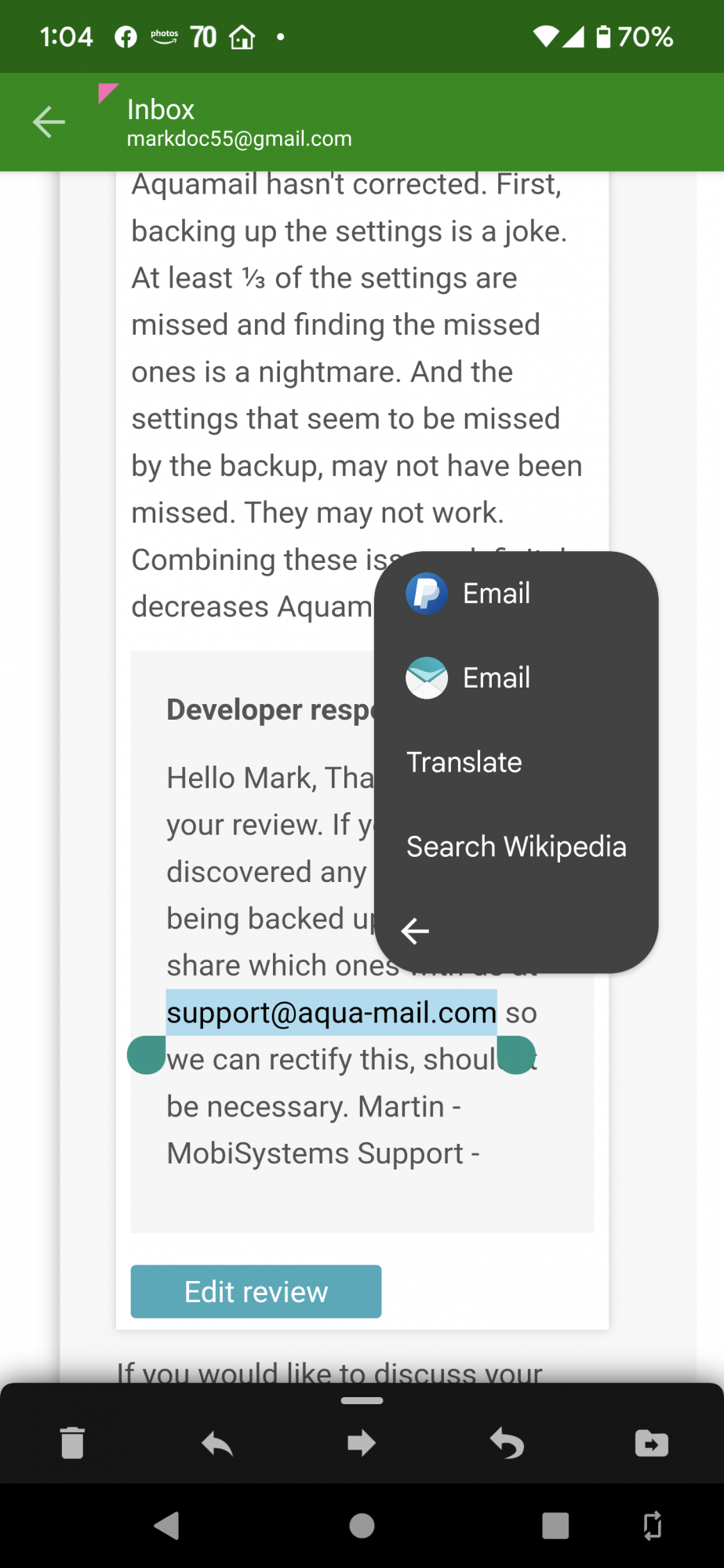

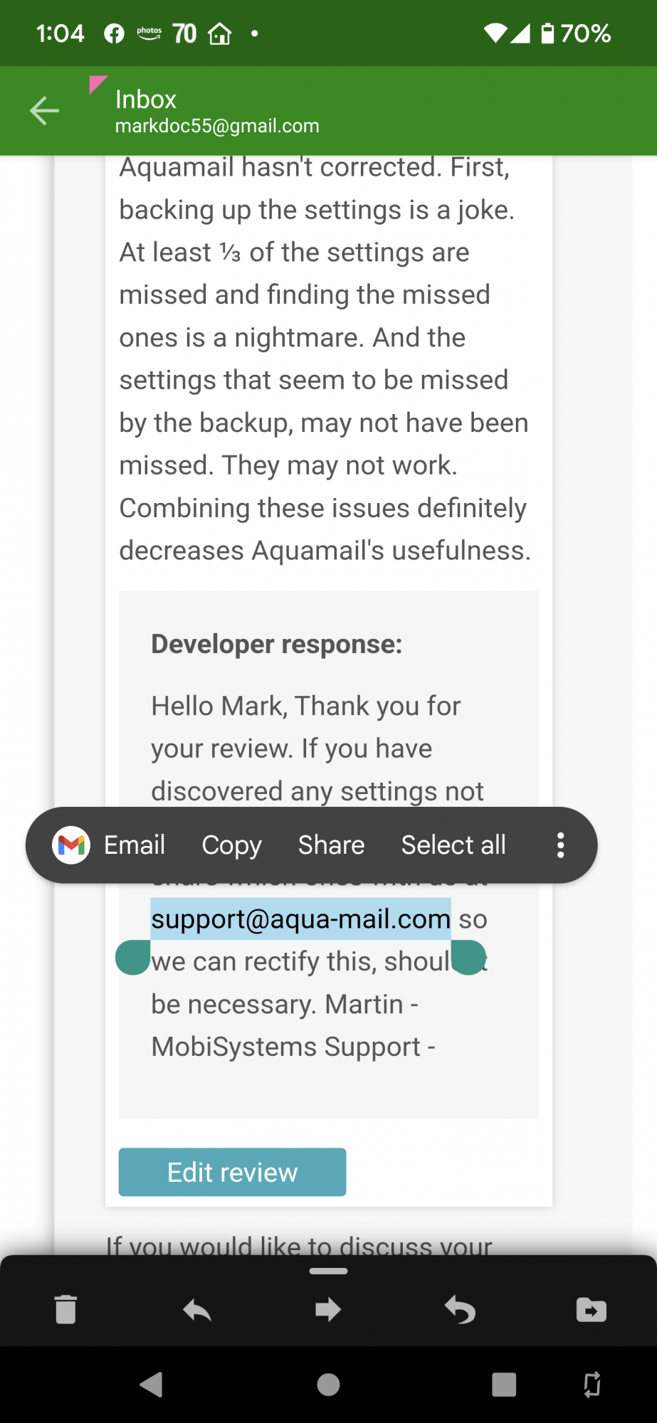

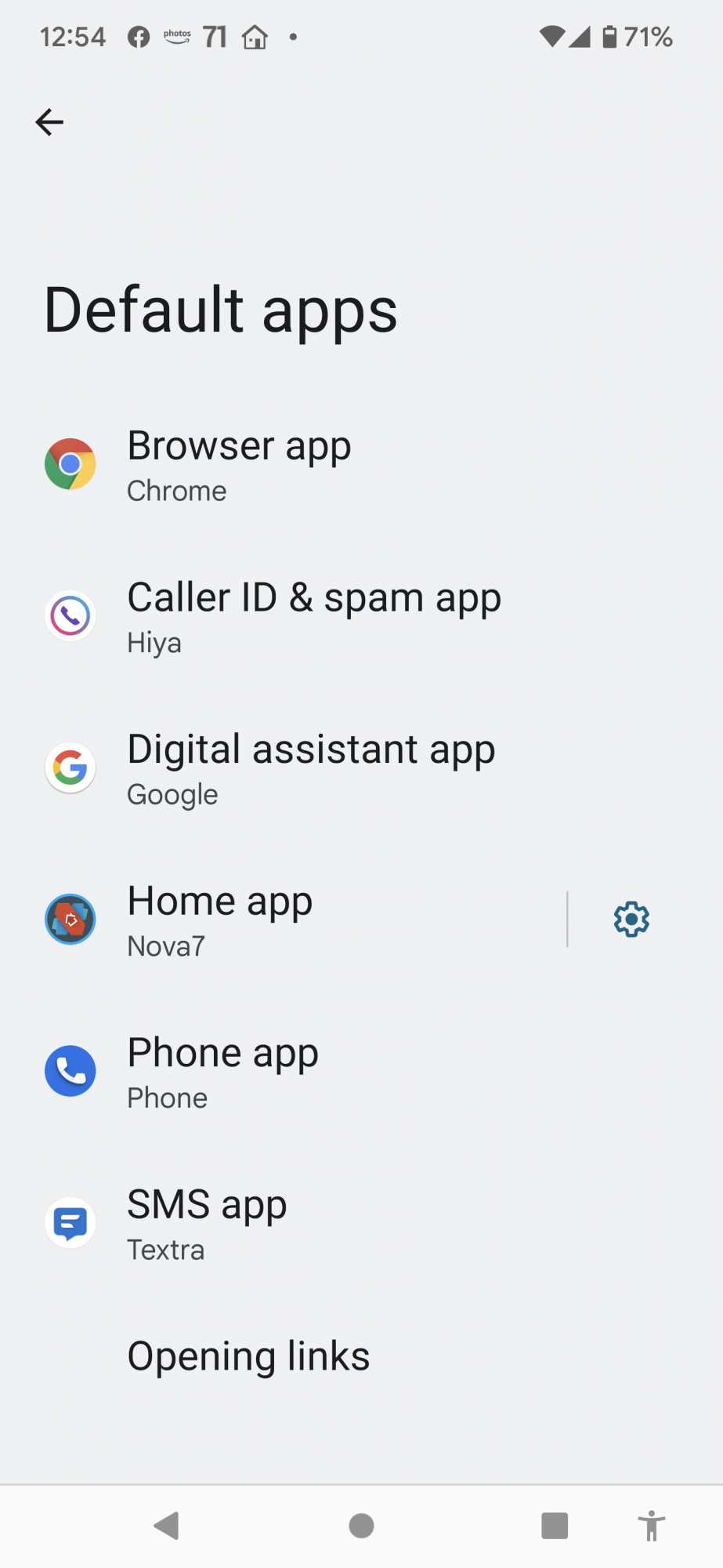

Sorry to be a pest but I cannot find how to configure the default email app. I'm using Aquamail and that doesn't have that setting. In the settings, it has listing for other areas but not email. When I highlight an email address it never asked me. It just opens Gmail. I turned off open supported links in Gmail but the pop-up still has Gmail as default and Aquamail is a selection when tapping on the 3 dots. I'd prefer not to uninstall Gmail but I will if I have to.

I don't recall any problem with Aquamail doing this when I last used it, but I've not used it for a few years now (since the original developer sold it to Mobi). Can you go into Settings > Apps, find Paypal and see whether there is an option there to clear it's status as default? Or search settings for "default apps" and see whether there is anything you can do there?

Based on your screenshots, it looks like you're referring to the shortcuts which appear when highlighting an email address rather than what happens when you tap on a 'mailto:' email link. A Default preference should kick in when you tap a link to perform an action, but that's not the same as the text selection shortcuts. Am I understanding that correctly?
If so, Paypal likely suggests itself to the system as capable of handling the "copy an email address and perform an action" task to make it easier to send money to someone via their Paypal email address. There is unfortunately no way to change how the system presents those shortcuts or what weight is given to each app, at least as far as I'm aware.
