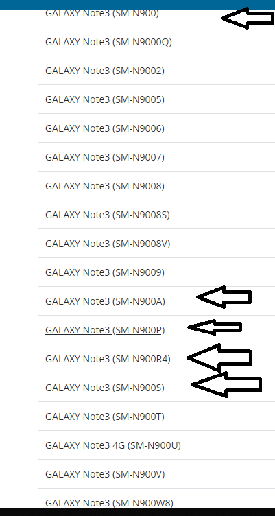

Looking at sammobile, I think I see your model but just wanted to be sure as I was seeing this:
If it is indeed the SM-N900, then I see a bunch of other countries/carriers here:
https://www.sammobile.com/firmwares/galaxy-note3/SM-N900/
Try flashing a valid stock ROM and get your Note 3 working again. Flashing a stock, Samsung will install a clean, unrooted Android OS, along with a stock Recovery so after you get your Note restored to a functional state again you'll need to go through the root process again. Go here to download the appropriate ROM:
https://updato.com/firmware-archive-select-model?q=note+3+SM-N900&exact=1&r=&v=&rpp=100
Be sure to choose the ROM that matches your carrier, don't mix and match. Stock ROMs are very specific and not interchangeable.
