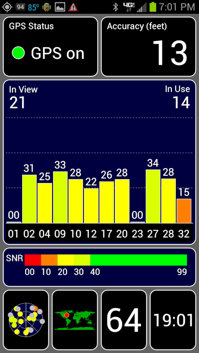

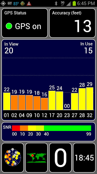

For what it is worth, I am consistently getting Accuracy between 10 - 15 feet using the free version of GPS Test for measurement, whether stationary (15/20 sats in view/in use) or moving (14/21 sats in view/in use) on my Verizon 32GB Pebble Blue Galaxy 3.
I have also had good luck with Google Nav.
