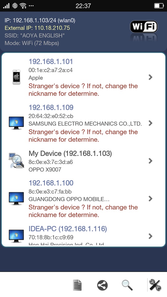

There are a few Android ones as well, this is one I've got that's just called "Network Scanner" you'll find it on Play.
This is my network, and it shows everything that's connected via WiFi and ethernet.
If your neighbour has a router plugged-in, it might show as Netgear, Linksys, Cisco, TP-Link, etc. depending on the make of the router
