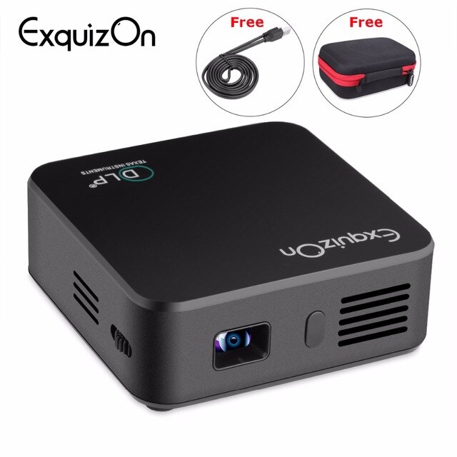

E05 dlp mini Rk3128 android 4.4.2 projector (Firmware Fix help needed)
E05 dlp mini Rk3128 android 4.4.2 projector.
help needed to fix this Firmware

You want to re-flash the firmware? That would need to come from the manufacturer. However their website is Chinese only, and doesn't seem to have any of their product firmwares available.
http://lianluo.com/wap/index.html

i can not find orignal stock firmware online but i tried Toumei.C800.series firmware. which is working loading android but when android start it show critical battery error and shutdown android immediately. how can i stop this shutdown ? can i send u this firmware can u edit to make it work.

Sounds like there is a hardware difference that makes the other device firmware incompatible. I certainly wouldn't be able to edit or hack it. I'm not s ROM dev, and I don't know anything about the technical details in this projector.
Think your only hope to get the original firmware, would he to try to contact Lianluo. They have Wechat and Weibo, and their site shows a Beijing phone number. How good is your Mandarin?

That was the website that was linked to from Newegg, who sold this projector in the US. And they do list Newegg as client. They're actually a sourcing, trading and export company, and the actual OEM who made this projector is unknown. That means the firmware for it is going to be pretty much impossible to find then.
Lianluo's Weibo lists all sorts of products, like electronics, apparel, fancy goods, toiletries, etc.
