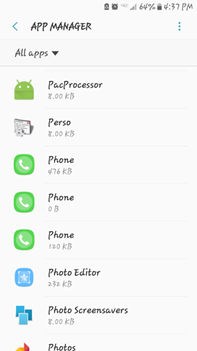

Apparently I have three pf the same phone apps. Not sure why I have three system phone apps. I cannot delete them either. Not sure if these guys are a problem of another sort. (There is a screen shot of the apps below)
