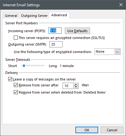

I do something similar, but here's how I do it. I have my PC (Outlook 2016 ... or whatever version is in the 365 subscription) setup as a POP3 client but in the account properties under the advanced settings I have it setup to delete messages from server after 10 days.
And, I have my phone setup as an IMAP client that maintains the sync with the server. After 10 days the mail drops off my phone.

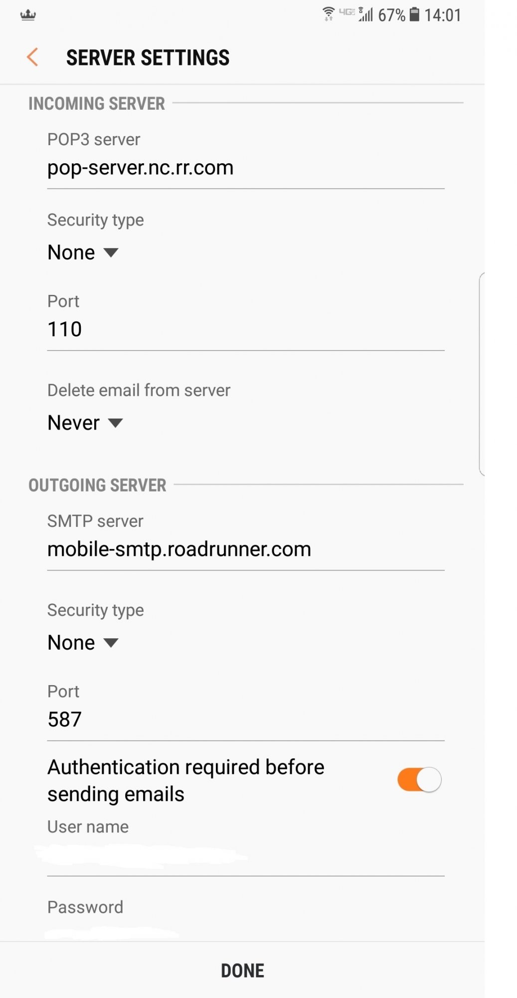

Could you post a screen shot of the incoming server settings? (blanking out the personal information, obviously)
Here ya go. I hope you don't see this as being argumentative. I'm certainly not being, but again, this is how I had it set up for YEARS with no issues until now. The Samsung tech said that he does the exact same thing with the same settings that he saw on my 3 & 8.
