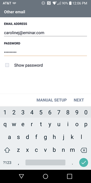

First thing to do is open the email app. I have an LG G6, but it should be close to the G3. If you already have your email partially setup it might try to open to that, so you'll have to go to the menu (three dots, upper right) and select Add Account.
This is the first screen you will see:
You enter your full email address and then the password i sent you. If you were to hit "Next" the email app should then try to poll the server and determine the rest of your settings automagically. Apparently your host's server isn't configured to do that (probably an old server.) Mine would, but for the purpose of this tutorial, please tap on MANUAL SETUP.

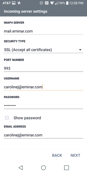

Now you are getting the configuration for your incoming server. This is where it can get confusing.
My server's name is shown above, but your email server will be something else. Enter all the information as shown above. Under security type, when you select SSL it should automatically change the port to 993. You have to accept all certificates because i self-sign and you'll get a security warning otherwise. Not to worry, it's safe.
Your user name will be only 'carolinej' but you must use your full email as shown. Please add the '@eminar.com'. The password field should be auto-populated, so no need to type it again.

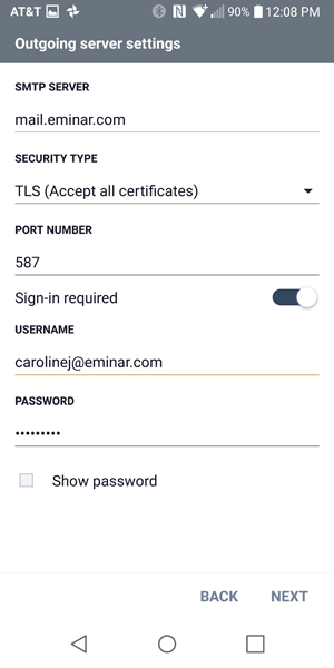

Now we move on to the outgoing (SMPT) server. This is giving you the ability to send email as well as receive it.
As you can see, it's pretty close to the incoming settings. Same server, so it's the same name, but depending on your host, it might be different. And here I use TLS to send mail. Just make sure your settings are similar or you won't be able to send mail.

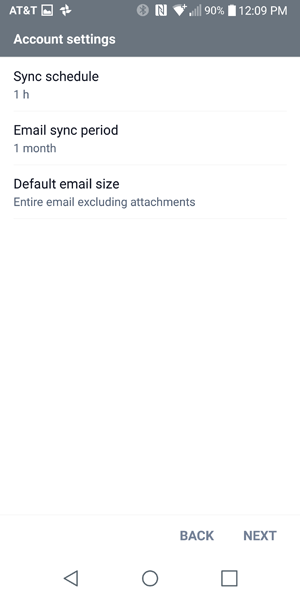

Finally, it will check the settings by trying to login with both sets of credentials. Assuming you entered everything correctly, you'll get to this screen:
This is telling the app how often to check for email. While many IMAP servers will try to push new mail immediately to the client, it's still a good idea to have the server polled for messages periodically.

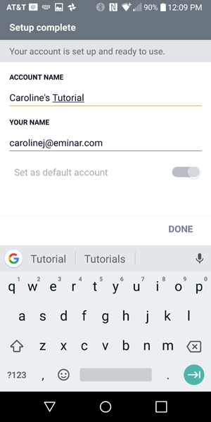

Finally you set how you want the account to be displayed

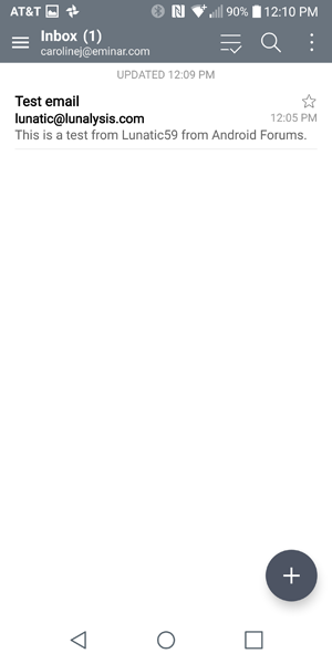

And click done. You should immediately get a notice that there is mail waiting.
I sent your new account a message from one of my other email accounts.
