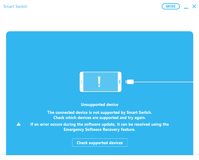

The device is connected to my PC into Smart Switch, but the software can't apparently recognize my phone anymore and it's displaying the following message:

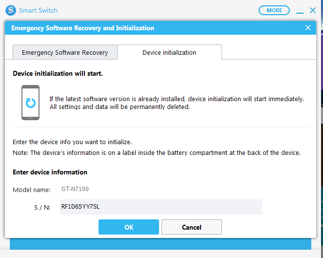

The problem is that I essentially cannot access the "initialization" tab in the More>Emergency Software Recovery even in this state. What I see is this:
when I actually should be able to see this:
How can I proceed?
UPDATE: I have found a solution myself, so I am going to post it here for whoever had, have or will have to go through my same issue.
Samsung's Smart Switch latest versions have been removed the capability to reinitialize your phone.
This happened due to people abusing this function for debranding.
You can find and download an older version of the software provided with that option in this link:
downloadcenter.samsung.com/content/SW/201706/20170601113339558/Smart_Switch_PC_Setup.exe

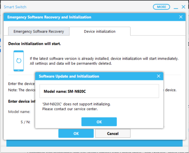

hi there.. i need help!!!
i followed this procedure but the smart switch that i used says, "SM-N920C" does not support initializing..
can you help me with this pleaseeeeeee... tried everything even in samsung kies it does not support..
hope you can see this and respond to it asap..
thanks...
