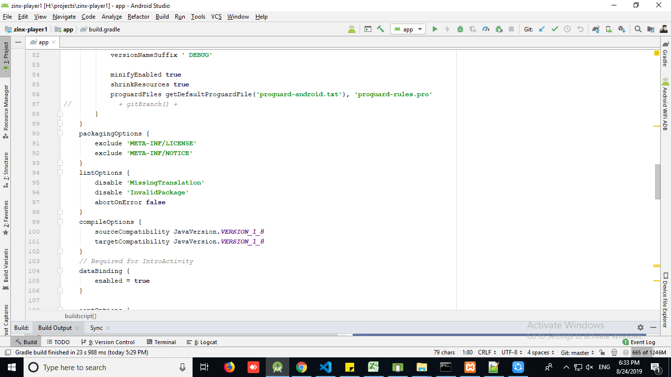

Error: Invoke-customs are only supported starting with Android O (--min-api 26)
As myself and my collegue running same android code in different os.when my collegue run the code in ubuntu() its code was successfully running.
he shared the code via bitbucket i am cloning same code and try to running in win10 but i am facing following error throw:-
stacktrace
com.android.builder.dexing.DexArchiveBuilderException: Failed to process H:\projects\zinx-player1\app\build\intermediates\transforms\instantRun\debug\0
com.android.builder.dexing.DexArchiveBuilderException: Error while dexing.
com.android.tools.r8.CompilationFailedException: Compilation failed to complete
com.android.tools.r8.utils.AbortException: Error: Invoke-customs are only supported starting with Android O (--min-api 26)
i verified the following link to check version compactblity everything.but not clear my issue
https://stackoverflow.com/questions...-supported-starting-with-android-0-min-api-26
my basic config:
android {
compileSdkVersion 28
buildToolsVersion '28.0.3'
defaultConfig {
minSdkVersion 16
targetSdkVersion 28
renderscriptTargetApi 28
vectorDrawables.useSupportLibrary = true
applicationId 'com.arun.carapplication'
versionCode 170
versionName '1.2.0'
multiDexEnabled true
