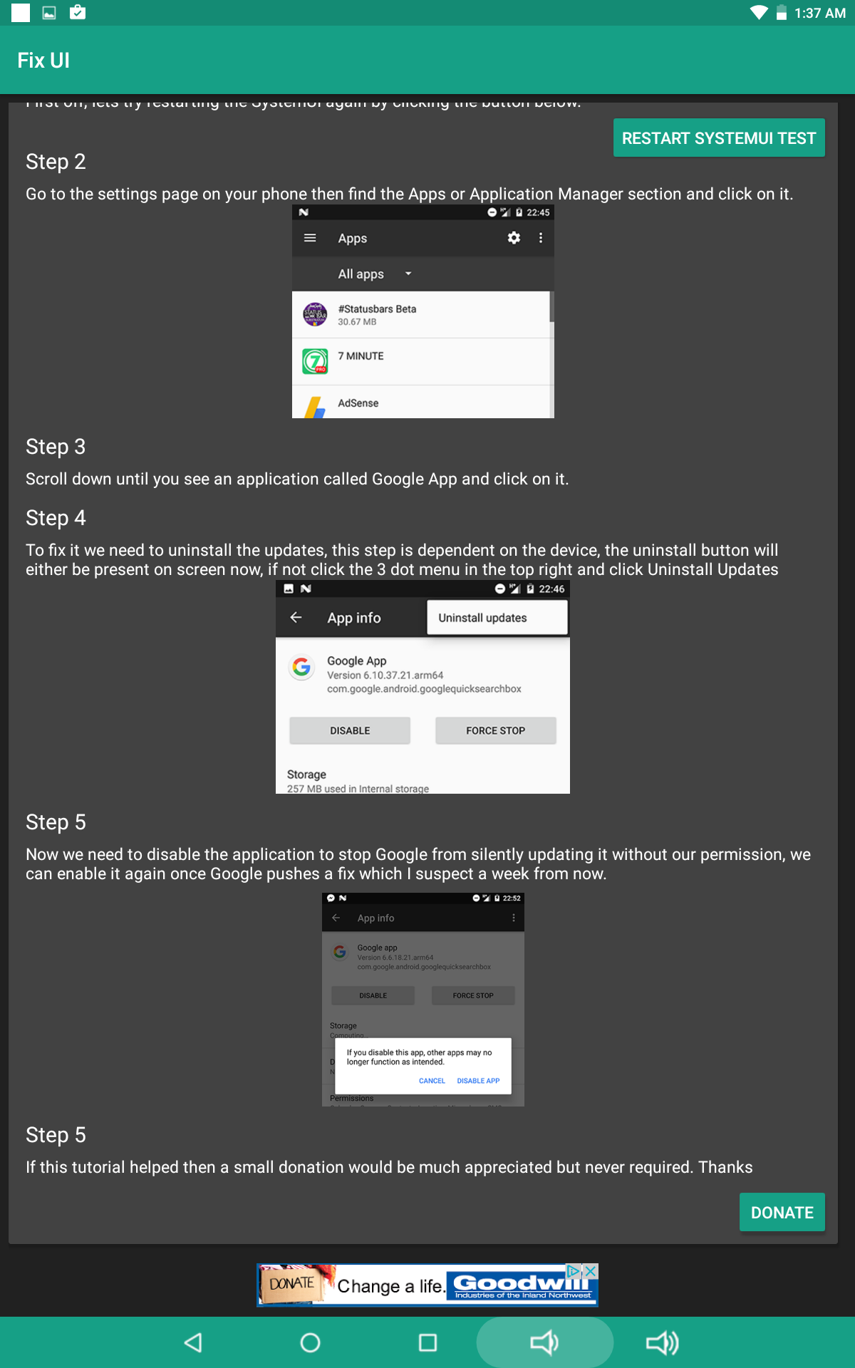

Hey, I've researched and performed several supposed "fixes" to the reoccurring annoyances like, "UI system not responding...", " Google Play Services...", "Google...", " Chrome...", "Facebook...", " Instagram... " & several others! I've uninstalled my app add ons (though maybe missed some?!), ridded cashed data individually, reinstalled then again uninstalled Junk-n-Stuffs til I'm spinning, twice factory reset BOT android tablets (because the IDENTICAL error msg's happen for both tablets!!!?), one factory reset was the 2nd which was led by the manufacturer. No fix. Last days I searched once again for help & found (see attached) newer instructions to follow. So I did. Left me without google search bar. I put in Norton. I'm now more confused than find comfortable. Aaarrggh. Got confused doing then REdoing for BOTH tablets, even tho I took notes per actions! So have done the suggested fixes from Jan. 21st of this year. But the article said to '...wait til google rolls out a fix, maybe a week...", and I couldn't find a darn date because once used the in for my tablets, two, won't pull up the identical article!!! Aaah! Any Help, Pretty Please? {I've more pics, but this post allows for but ONE!?} Thanks sooo! Shannan
