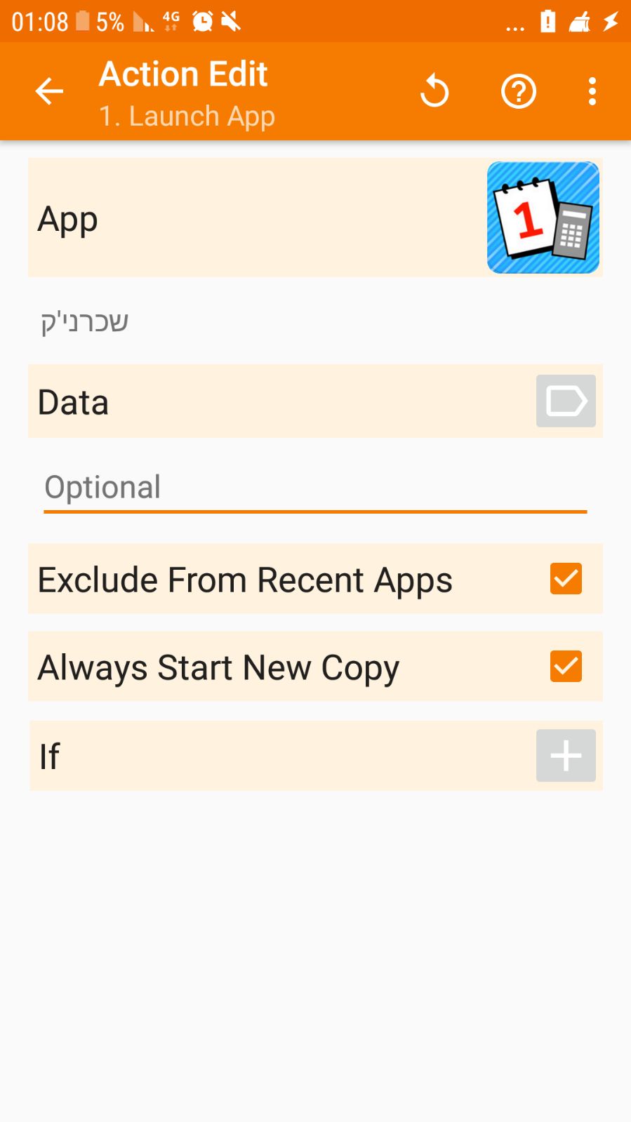

i need 2 ask tom where 2 put the the stop command in which page i attached a file can u tell me if this is the right page
It is impossible to know what you are asking by you posting a screenshot of something.
Enter: Anon
A1: Launch App [ App:Calculator Data: Exclude From Recent Apps:Off Always Start New Copy:Off ]
A2: Stop [ With Error:Off Task: ]
Is the Enter Task that is executed when the trigger in the profile invokes it.
Anon means it is unnamed.
A1 is the first action
A2 is the second action
Assuming your post is positioned at the first action you tap the back arrow in the top left corner and then enter Stop from the Task actions.
