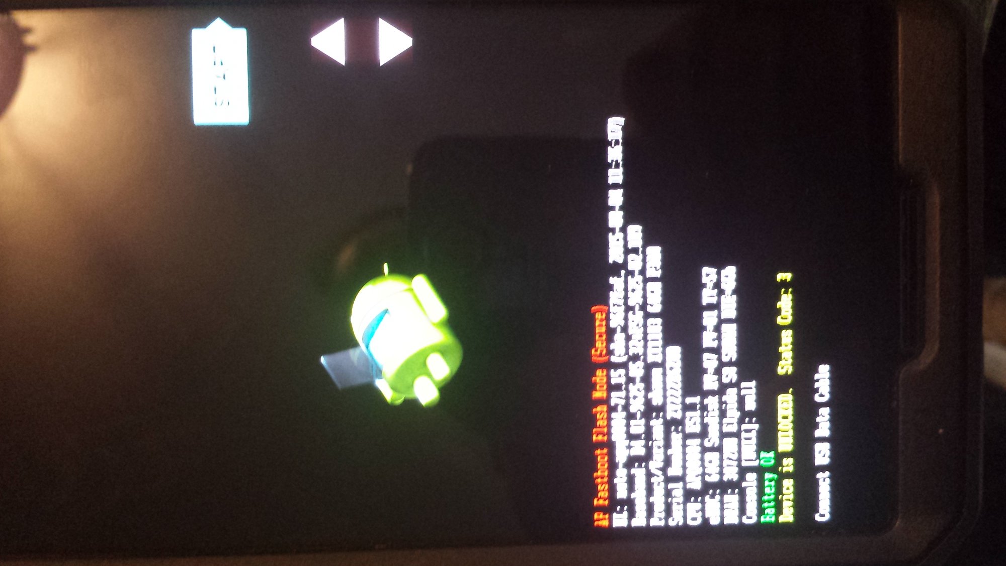

On your phone's screen while in fastboot mode, does it say "unlocked" ?
(Mine shows it in yellow, attached)
No, but it shows nothing other than just
=> FASTBOOT mode...
in very small text right at the bottom unless it is doing something specific. However I had done fastboot oem unlock, and fastboot getvar unlocked returns yes
