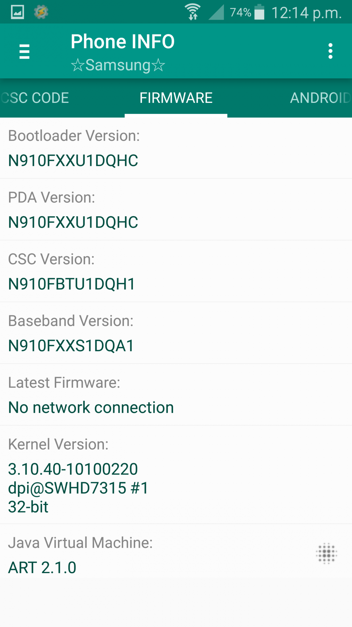

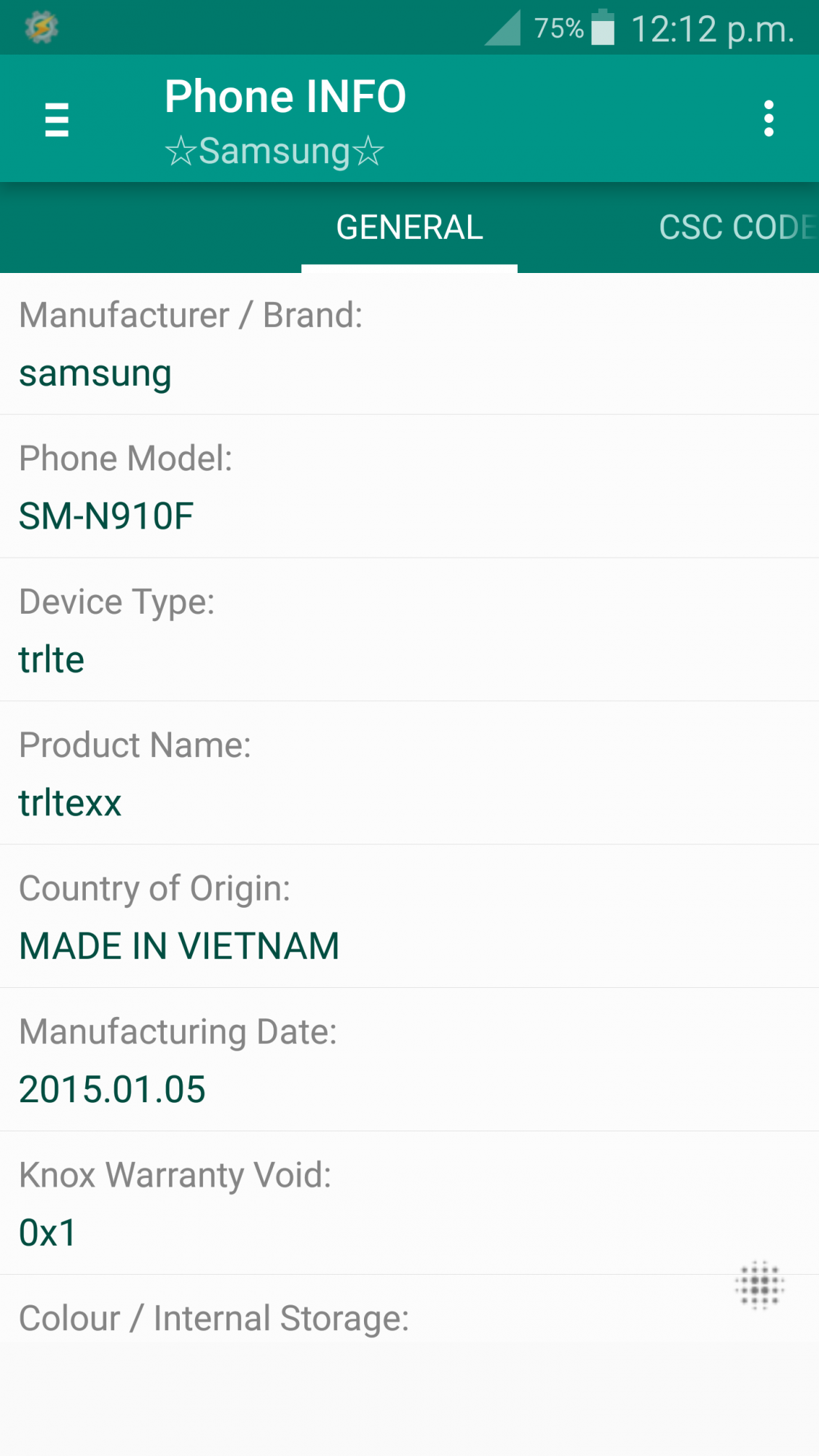

Thanks here's the firmware, etc screenshots.

The Product Code shows that it was built for BTU which I think is generic UK without any carrier branding.
International version can be confusing.
You should be able to flash O2 firmware if you want. If it falls in Odin, flash the BTU.
