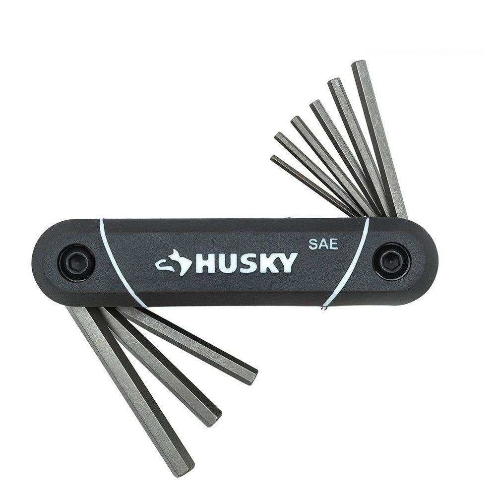

You will find a hex sided inset at the very bottom of the motor running the disposal. You might even find the hex key that fits it somewhere under the sink. If not, you will want to find a hex key that fit that inset and turn the motor by hand. Your disposal is obviously hung up on something and the motor can't rotate. Turning it by hand a few times until it's free of the stalling culprit, you should be able to then turn on the disposal and it will run. Do not attempt to free the snagging agent while the disposal is on.
Where do I get a hex key? How do I make sure it's the right size? What do I do if that doesn't work?
Ok, believe it or not, I got 3 sets of hex keys or else it's 2, depending on whether STARS count. I guess it was kind of a bargain, less than 8 bucks at Harbor Freight. I'm lucky they were open. I cleaned a bunch of gunk outta there and then tried the 2nd biggest metric. Actually it was the 3rd biggest 1st, but it didn't fit very well. The 2nd didn't do much. It's still humming. At least it's almost running clear now.
I would have guessed it to be a SAE hex key around a 1/4 inch. Twisting the motor back and forth should free whatever has it hung up. It will freely rotate once the offending article is cleared and the motor should then run on its own.

Hallelujah, it worked! The SAE 1/4" did the trick. It still sounds a little grindy but the water is flowing right through it. Now I just have to figure out the heater. It was really windy the other day and that might have somehow blown out the pilot light. It's in a sort of closet but I guess it has to have an exhaust vent or something that way. The trouble is that there's a front panel that's held on with nonscrews. It's a real pain to open.
