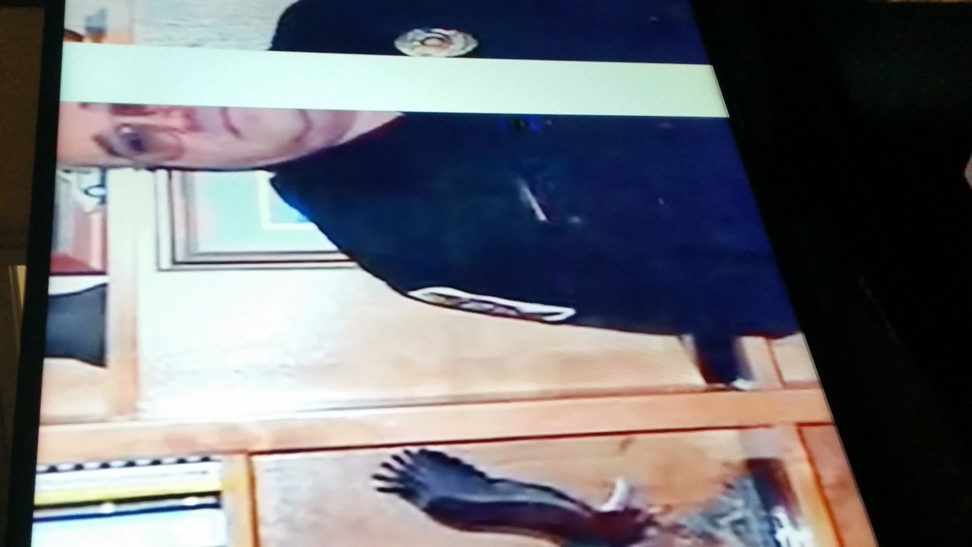

I got a uaed tv set from a friend. It works great (thank goodness something does) except that there is a vertical white bar near the center of the screen. I was told this is probably because it got cleaned too much with Windex. Is there any way to fix it, especially cheap and/or easy?

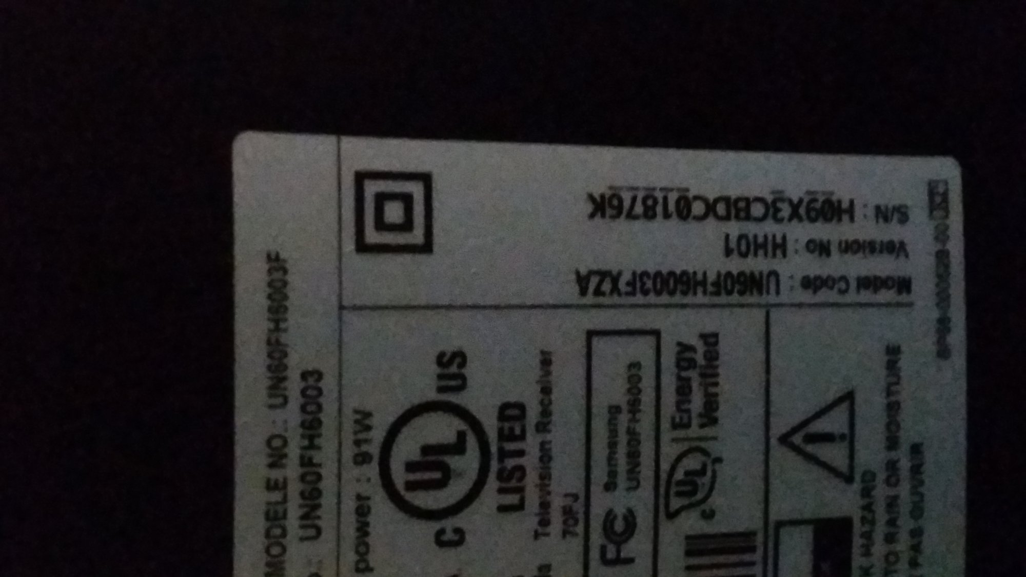

If it is, what can I do about it? I couldn't afford another one. By the way, I neglected to mention that it's a Samsung, maybe 35 or 36 inches.

I agree that the vertical bar on your tv is hardware damage. It's so thick it'll be hard to live with.

You'd have to spray a heck of a lot of Windex on it for the liquid to run inside the TV and get into the connectors. The warning about using certain types of cleaners generally refers to damage they can do to the screen surface due to abrasion or chemical reaction. But it appears that in this case the screen was damaged internally from pressure or impact and there's no fixing that. And regardless, unless you know what you're doing and have the proper experience you should not attempt to open it up and mess around inside.

You can't. Plus taking it somewhere to get it fixed usually costs as much as a whole new TV from anywhere
Which is why you don't see any more TV repair shops, so even if you were so inclined there isn't really any "somewhere" to take it. The model for most modern consumer electronics is "disposable" and not "repairable" as in years past. It breaks, you throw it out and buy a new one.
