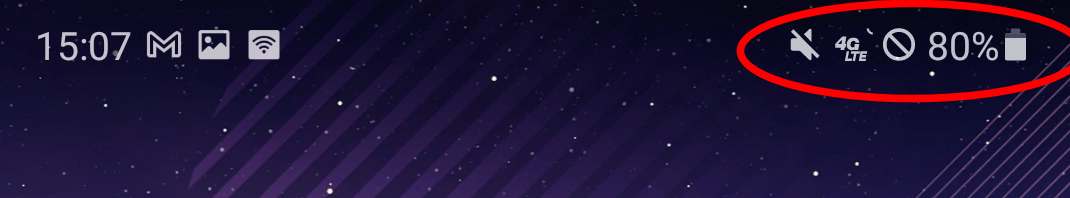

Hi Hadron, thanks for your reply. I have 4G LTE service, but no signal bars. I have that symbol that looks like a no entry sign (see attached screenshot). When I try to make a call, I get the message "Mobile network not available". I cannot receive or make calls or texts.
Unfortunately I don't have another compatible phone to use to test the sim - I am travelling, and my 'backup" phone is an older phone that is not compatible with this "Warp 5G". I doubt there's any issue with the sim because my data service is working perfectly. I'm pretty sure it's something to do with my phone. Maybe I must just bite the bullet and do the damn reset. I had to borrow someone's phone at the airport to call the rental car company when my flight was delayed!

Yeah, you don't have any mobile connection at all there. I don't see any warning about it being an unauthorised SIM, so my guess would be either a SIM fault or the carrier have fouled up and failed to enable service for that SIM. Like the others, I would think that a faulty SIM is more likely (I've never been given one that's DOA, but I've had a couple go bad in use, so it's far from unknown).
Just on the off chance, have you done a scan for available networks? Just to check that you aren't in a blackspot for the new carrier (if a scan shows other networks but not yours that might be a possibility).

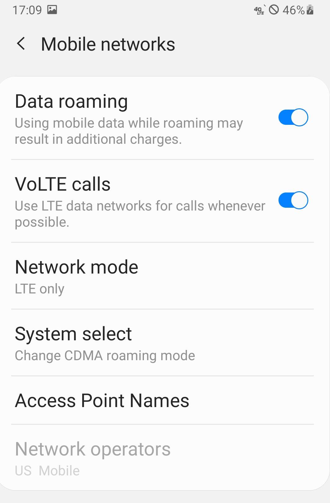

...... All that they can suggest is to reset my network settings, but I'm loathe to do that because I don't want to lose my saved Bluetooth and Wifi connections. And I suspect that might not work anyway.
That does appear to be a big stumbling block as far as actually fixing the problem. Yeah, it might not be a solution but there is a chance it will.. Weigh your reluctance to move forward against being able to use your phone as a cellular service phone again. Losing saved Bluetooth pairings just requires you to re-pair your Bluetooth devices, losing saved WiFi network passwords is more annoying.

"Network operators is greyed-out" - I've never seen that even with a carrier-locked handset, but of course I'm not American and your carriers do seem to be the most controlling in the world, so maybe I shouldn't be surprised :(

The handset is not carrier-locked - I bought it on amazon and have subsequently used it with local sim cards at home in South Africa, in Turkey, in Qatar, in Pakistan, in India, in the UK and in Spain. (By the way, it's been illegal for many years in South Arica to carrier-lock a phone)
From my screenshot, you can see that it shows 4G LTE. I assume that's how I'm getting data service. I have used the internet on the phone with Wifi turned off, and in public areas with no Wifi. As to how it can be possible to have 4G LTE data service yet not be able to make or receive calls or texts - well, that's what I'm here to find out!! It's got something to do with the fact the this US Mobile sim card is using what they call "Warp 5G" and makes calls using VoLTE rather than using "normal" cellular networks. At least that's what I've read. If someone can explain how tht all works, I'm all ears!
But it also has no signal bars and an explicit "no signal" symbol (that crossed-out circle). That's what's confusing: those signal bars aren't for a voice service, they are the cellular connection strength, and it seems to be zero. Is it always like that, or was that screenshot just taken at a time when the signal was zero?
