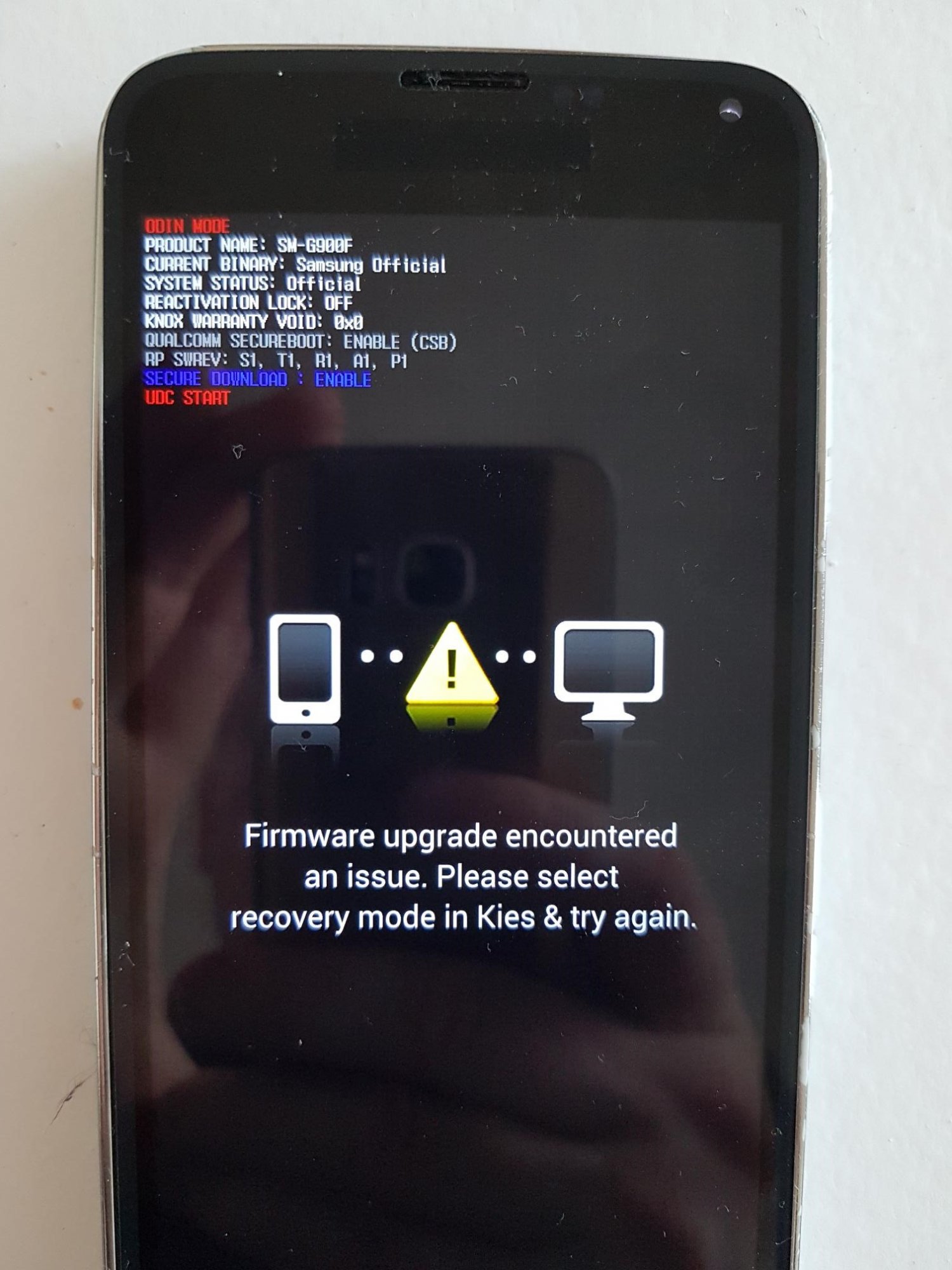

i installed a screen from aliexpress, screen works, phone did not boot, i thought i needed a firmware, now i have this screen:(

[QUOyes, but i need to know wich firmware, i already tried 2 diffrents ones and keep getting the failed message :(TE="Xavier Black, post: 7746406, member: 1890353"]That means is bricked..just flash the firmware and you will he good..[/QUOTE]

i recieved new screen from aliexpress, the phone did work and screen, but it was locked from the previous seller, so i booted up the phone in special mode and performed a factory reset, then the phone booted but stayed stuck in the samsung logo, ........
then i thought i just flash the firmware,,,....
now i am stuck with this problem :(
Try removing the battery. Wait a few seconds and put the battery back in.
Use the button combination to boot into recovery. If I remember correctly, the second or third line should show the current firmware version.
While in recovery, try factory reset again.
@ Jfalls63
srry it goes straight to the screenshot i did in the beginning of the post.
Press and hold power, volume up and home till phone starts to boot, then release the power button only while continue to hold the other two should take you to recovery.
Another thing to try would be the Software Update and Initialization option with Kies3 or Smart Switch.
It will select the correct firmware for your phone based on the model number and SN.
http://www.samsung.com/in/support/usefulsoftware/KIES/
I googled one more time
I found the stock for my country
It worked
Thx all for the help

Samsung have provided a PC application for errors such as this occuring. All you have to do is connect the device with the pc with the application and the phone should detect its in emergency recovery mode (if not in the tools or options menu there should be an option called emergency device recovery) and will install and upload a new version of the firmware needed
Best of luck to you
