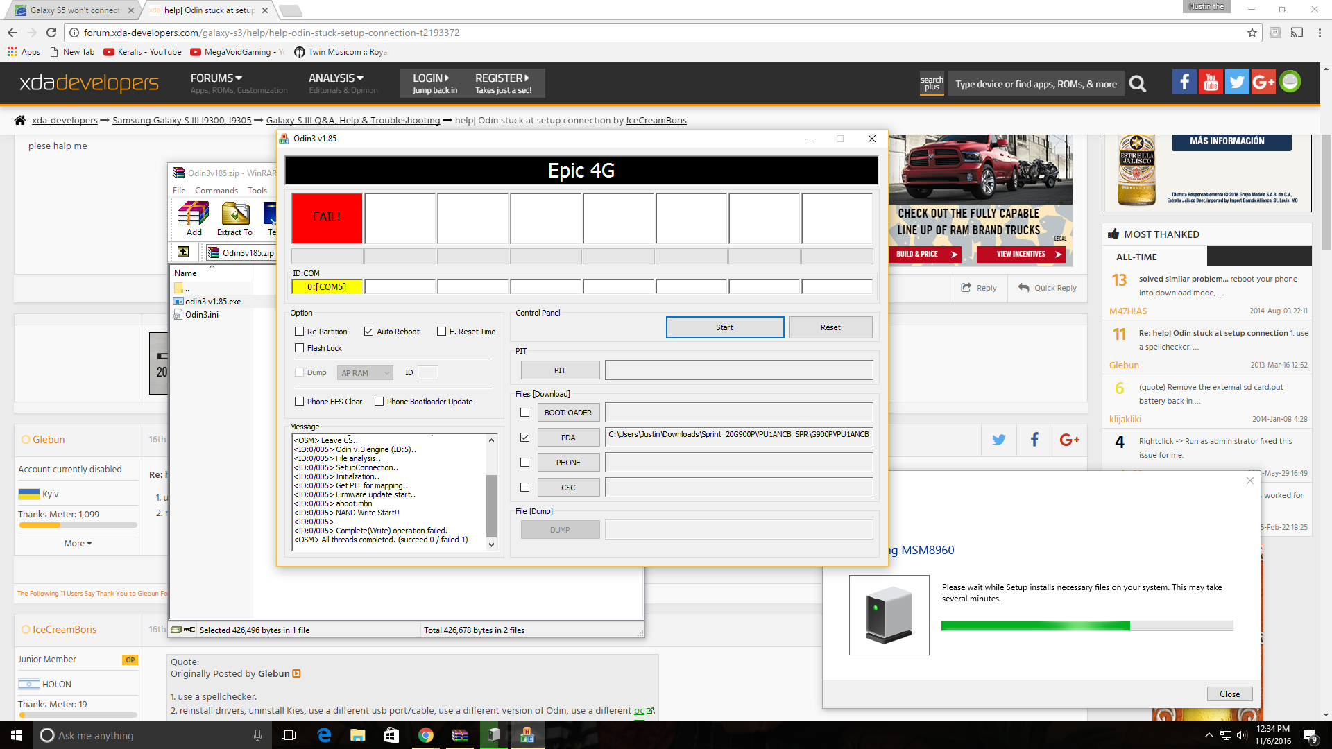

Thanks, I'll try to flash it on Odin, it's failed a couple of times but I'll give it a shot and see how it goes.
Looking at the computer screen shot, the firmware you are trying to flash is the first released version and you are using a early version of Odin.
Most Samsung devices you cannot downgrade so you need to try and flash the newest version available.
Go to the Sammobile link above and create a free account. Free download is slow but trusted site.
Instructions for flashing are at the bottom of the download page. Also link to Odin 3.11

I just flashed the stock rom you provided, it worked, but it still won't connect to LTE when I switch it to LTE/CDMA
