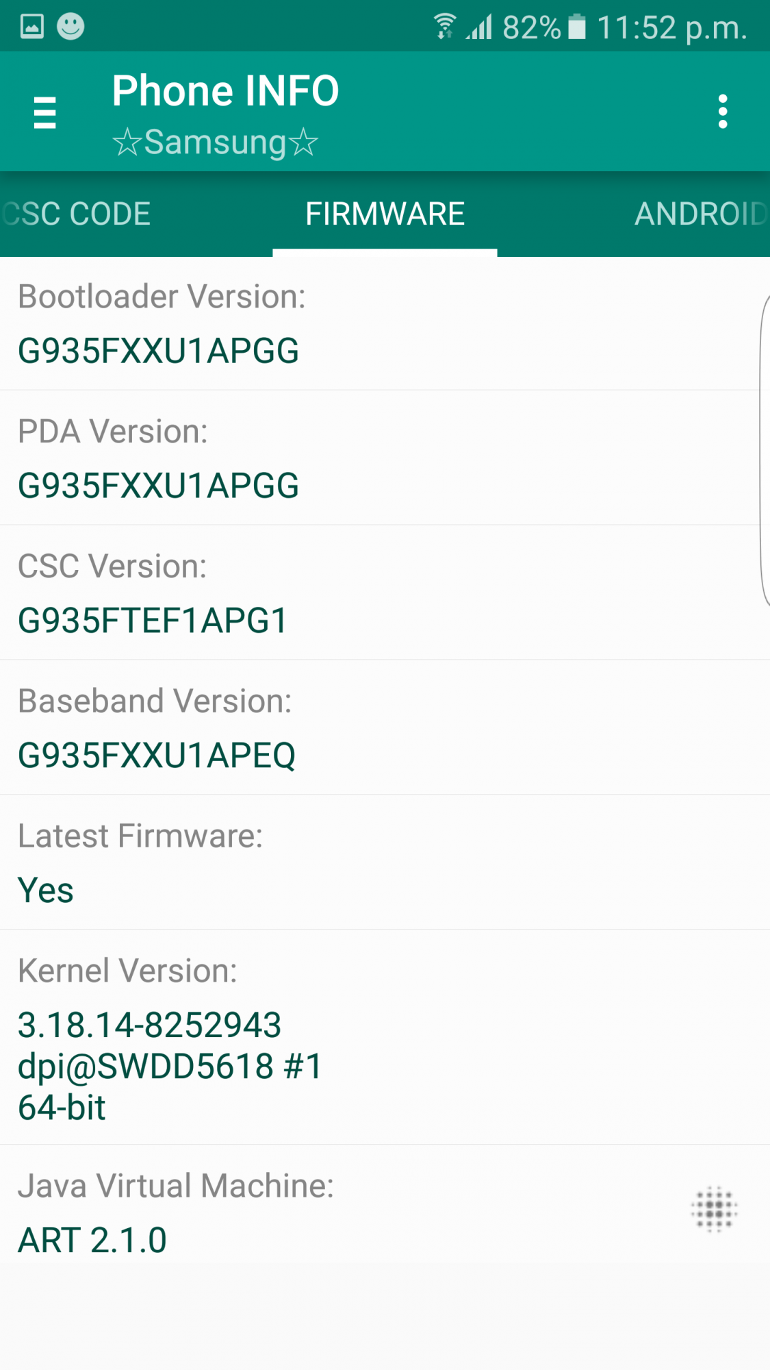

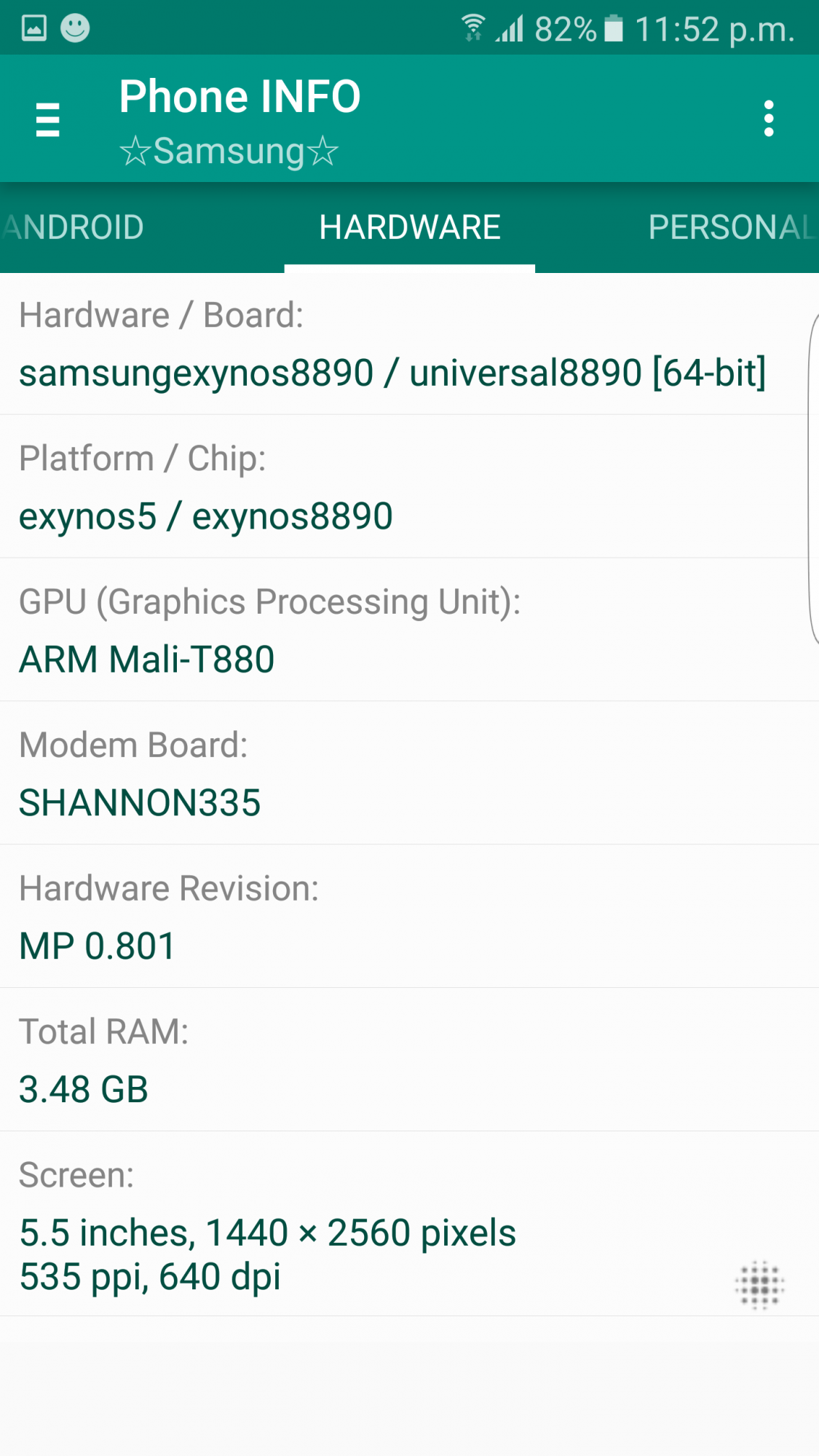

I'd you need more information just let me know. These pics should tell you everything about my phone and I didn't post the personal bit like you asked.
EDIT: ok I found something pretty important, I just realised that the number I was trying to match was the "Baseband Version". Thats why I was getting the Greek version.
From the pictures I posted I can see that my PDA Version is: G935FXXU1APGG
My CSC Version is: G935FTEF1APG1
when I matched these numbers up with the firmware on the SamMobile website it lead me to the O2 Germany Firmware which makes sense because as I said, my phone came with german O2 bloatware which I uninstalled and the default language setting was German. I think its safe to flash this firmware but can someone please confirm first just to be sure. Thank you
