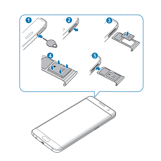

To insert a MicroSD card into the Galaxy S7 Edge, first you'll need to remove the SIM tray on the top of the phone. Here is the process in an animated GIF from Samsung:
Step-by-Step instructions:
  • Insert the ejection pin into the hole on the tray to loosen the tray. Ensure that the ejection pin is perpendicular to the hole. Otherwise, the device may be damaged.
  • Pull out the tray gently from the tray slot. When you remove the tray from the device, the mobile data connection will be disabled.
  • Place a memory card on the tray 2 with the gold-coloured contacts facing downwards.
  • Gently press the memory card into the tray to secure it.
  • Insert the tray back into the tray slot.
If you insert the tray into your device while the tray is wet, your device may be damaged. Always make sure the tray is dry. Fully insert the tray into the tray slot to prevent liquid from entering your device.
