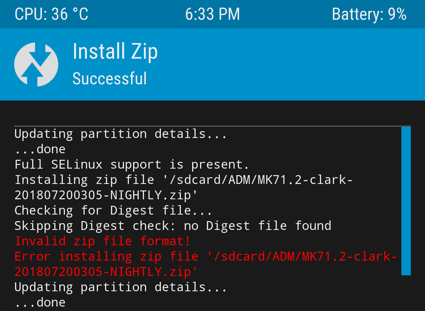

I unziped the ROM and went to /system/app and deleted xposedinstaller and that's it and compressed it from my PC and it didn't work.
I then did it with ES FIle Explorer unzipped it removed the xposedinstaller and compressed it and still didn't work this is the error that I got.

Umm, no. Lol. It's possibly an unsigned zip, zipped with pure images, or the Dev didn't check the zips themselves before upload.. I've gotten that error when I made a zip with just images, had to convert to sparse DAT and all was well
Oh.. If ya unzipped the ROM and erased xposed then rezipped it, it may have been accidentally zipped into a folder instead of all normal files in root of zip.. Which means TWRP can't see the meta-inf (& install) folders that may exist. Don't zip up the MoKee folder the ROM extracted to. Hope that helps
