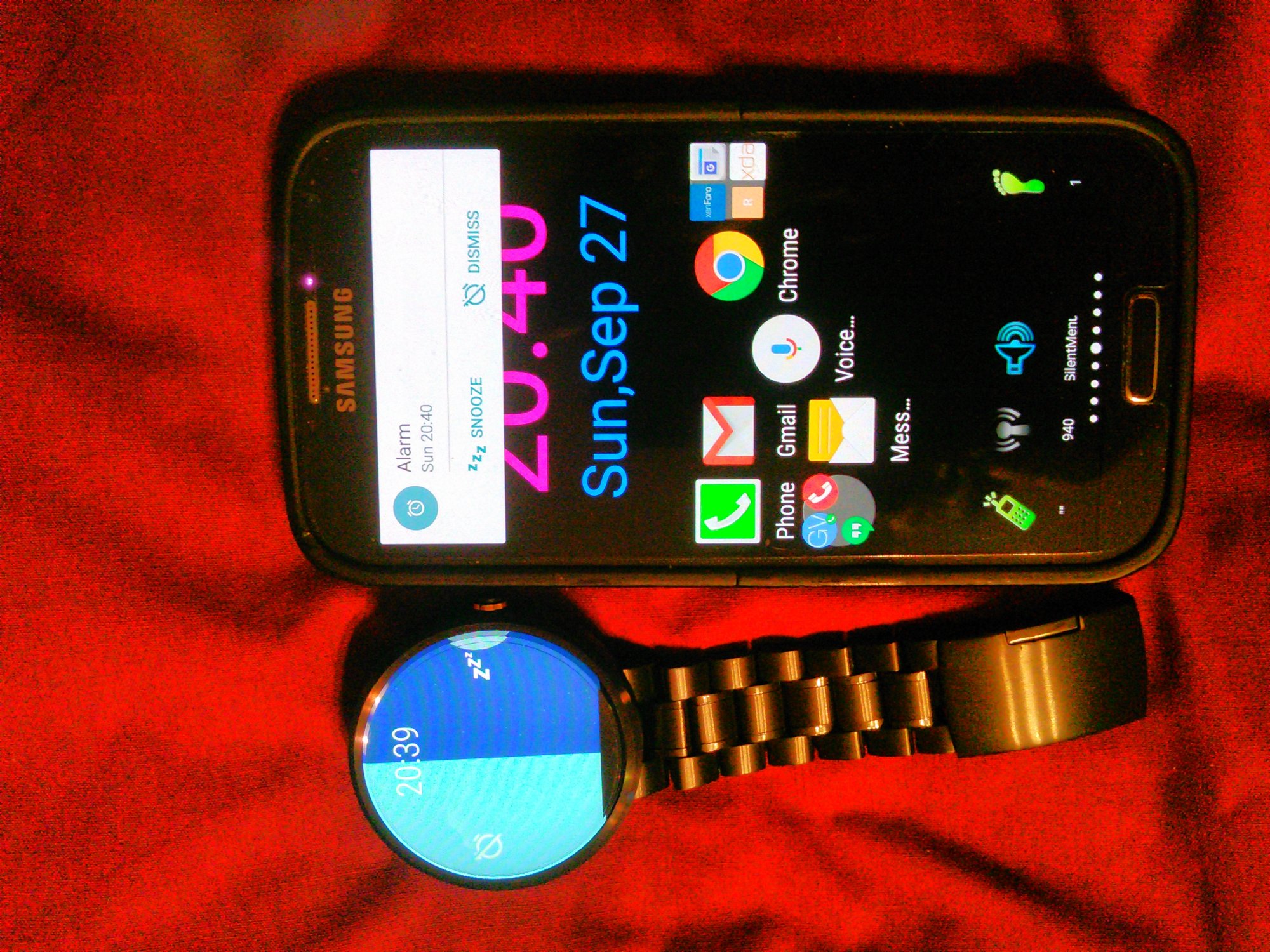

Below are screen photos which indicate the three interfaces I mentioned above (click for full size image):
  • AlarmAfterPhoneScreenOff.jpg illustrates C2A and C2B (these two are labeled opposite but actually swipe in the same direction)
  • AlarmWithPhoneScreenOn.jpg illustrates C2A and C2C
Nice write up. I was swiping in the wrong direction to dismiss an alarm on my watch, so I agree that the watch interface is confusing.
For C3, Xposed has a module to force the clock app to open to the alarm screen.
Thanks. I'll see if I can find that xposed module, although I'm guessing it may be applicable to nexus only, not Samsung.
In the meantime, I'm trying to formulate a simple rule to deal with the three screens mentioned.
If it was only screen C2A and C2B, I'd say:
Ignore the screen and just use the same convention as notifications (swipe right to dismiss.. which means the other direction is snooze).
BUT, we can't ignore the screen when we throw C2C into the mix…
….So I have to refine the simple rule a little bit:
Look at the screen to see whether a swipe or a tap is requested.
  • If a swipe is requested then ignore the depicted direction and just follow the same covention as notifications described above.
  • If a tap is requested, then look at the screen to decide which button to tap.
