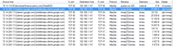

I rooted my phone over the weekend and downloaded a program called Shark to capture all traffic from the phone. Last night I got the Watchdog lite cpu alert for google maps while I was capturing the packets.
after briefly analyzing the packets it looks like google is sending some binary files down to the phone every night. I don't know if they are updates for maps or maybe advertising info.
Here is a screen shot of the file list:

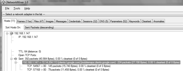

Ok, I need to look into this a little more as I am not very good at looking at pcap files. It appears there was also some data sent back to google, around 27KB, which doesn't seem like a lot. I'll try to look into the details more.
