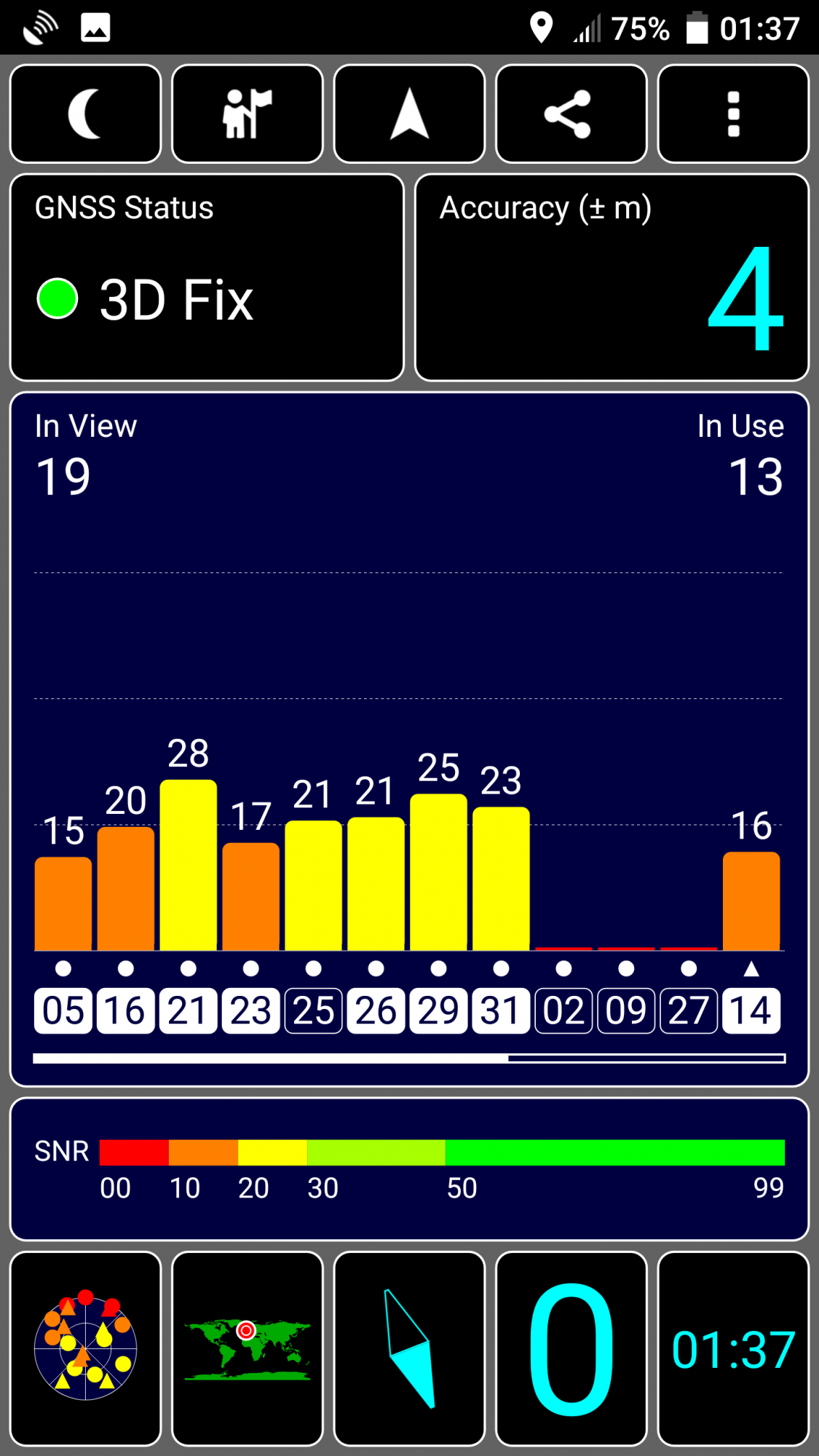

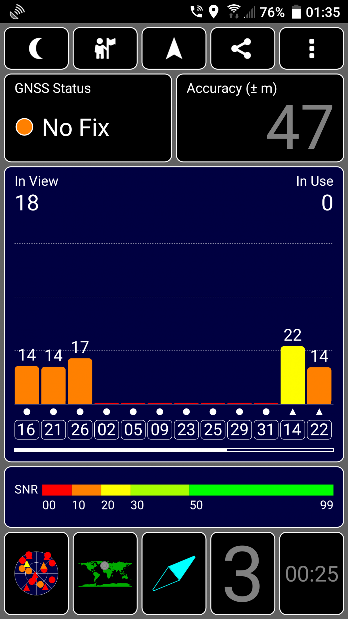

Hi, having read through your previous thread I notice you are using 'GPS Status and Toolbox'.
Might I suggest that you try 'GPS Test Plus'
https://play.google.com/store/apps/details?id=com.chartcross.gpstestplus
It gives a far clearer picture of the satellites within range and the respective signal strength of each one, and will display up to a total of 24 satellites.
The first screenshot is taken inside the house, standing next to a window and the second screenshot is taken when standing well away from any windows.
In my experience the signal to noise ratio (SNR) needs to be in the yellow or green areas for at least three satellites to get and maintain a reasonably accurate fix.
If I step outside, the number of satellites and strength of the signals increase significantly.
It could help to determine whether or not you have a problem with your GPS receiver.
The signal to noise ratio (SNR) needs to be in the yellow or green areas for at least three satellites to get a fix.
