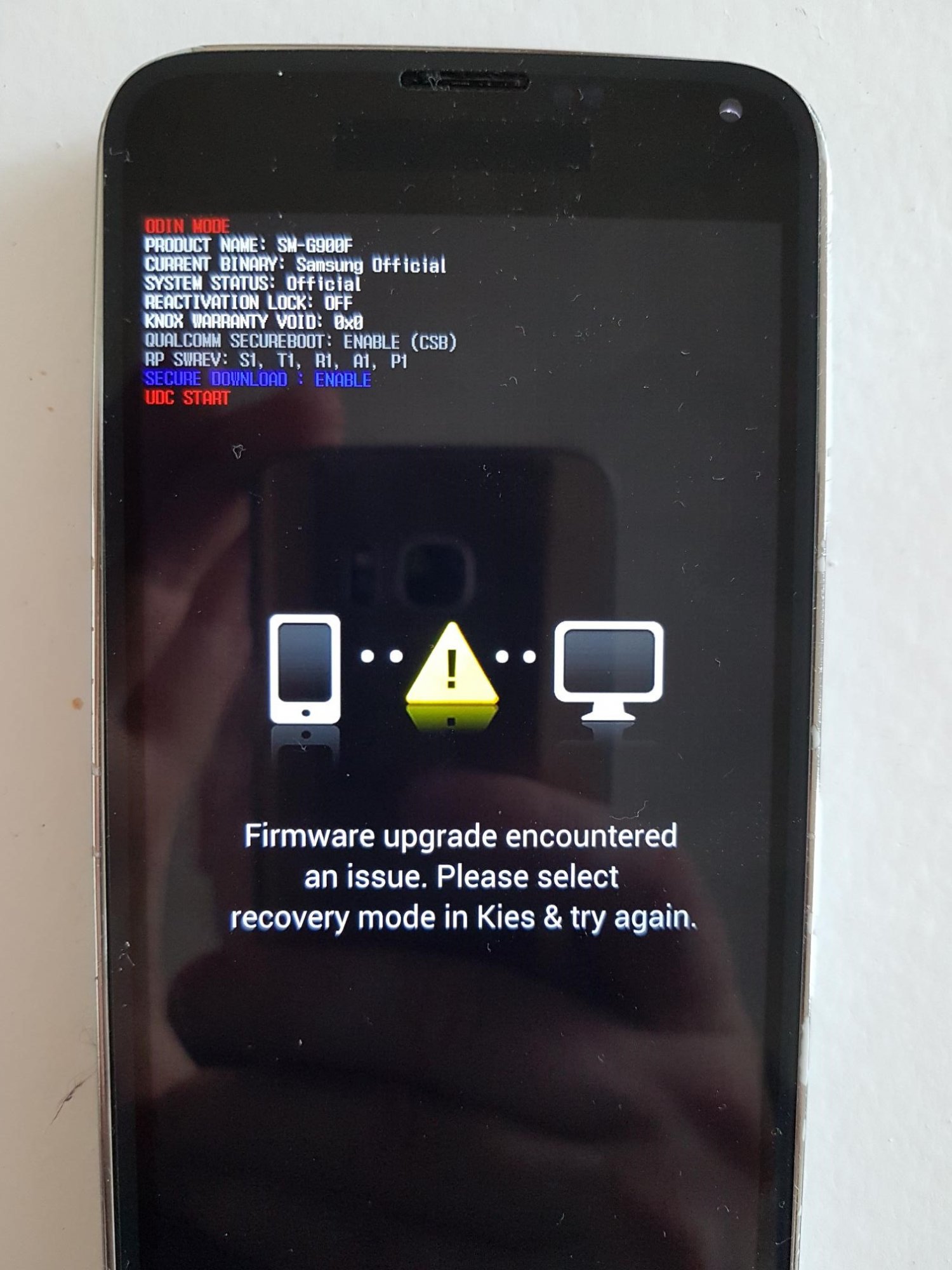

Hi there ,
im looking for some android hero help !
Samsung Galaxy S5
model sm-g900f
ssn -g900fgsmh
fcc id a3lsmg900f
i installed a screen from aliexpress, screen works, phone did not boot, i thought i needed a firmware, now i have this screen:(
i cant do it on my own i need some help from the expert:) please
thank you so much for any help kind regards
