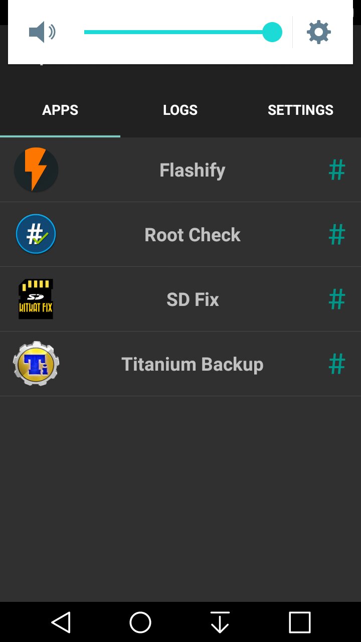

Thank you, it worked for me as well. Question: Where did TWRP App go? When do I use it? Do I need to flash every App I download? When do I back up?
Thanks.

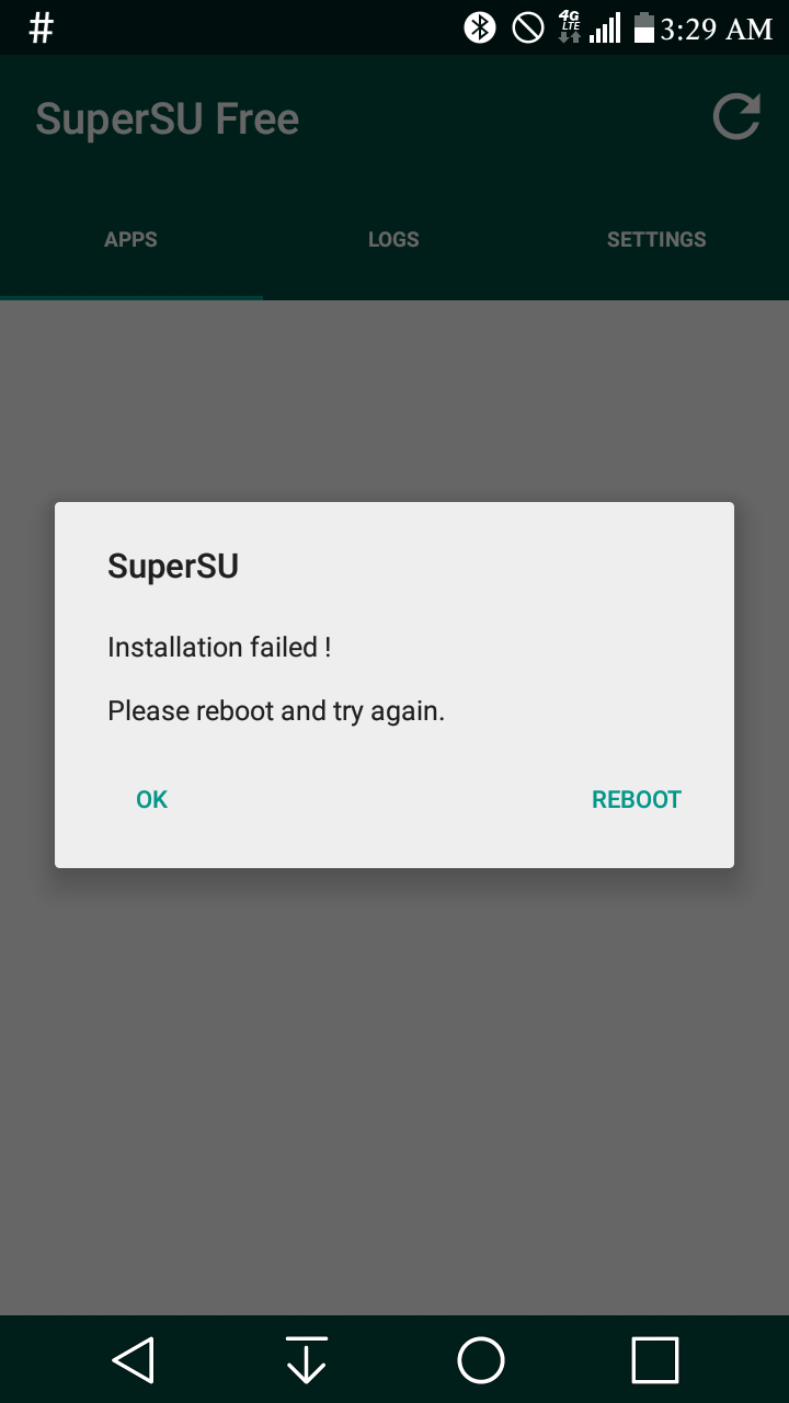

I hit yes when ss asked to update but the it says if im recovering to normal ot twrp? Above on the structions it says it will say reboot so im not sure if im supposed install twrp or what.. Lg g stylo
Ok i did that and it said there other superusers and if it wanted me to uninstall.. I followed as best i could.. Grrr
Okay so you're rooted and have SuperSU, yes you definitely want to flash twrp. I'd recommend making a backup of everything from within twrp as well. Remember twrp is only for the Metro and T-Mobile Stylo, nothing else.
