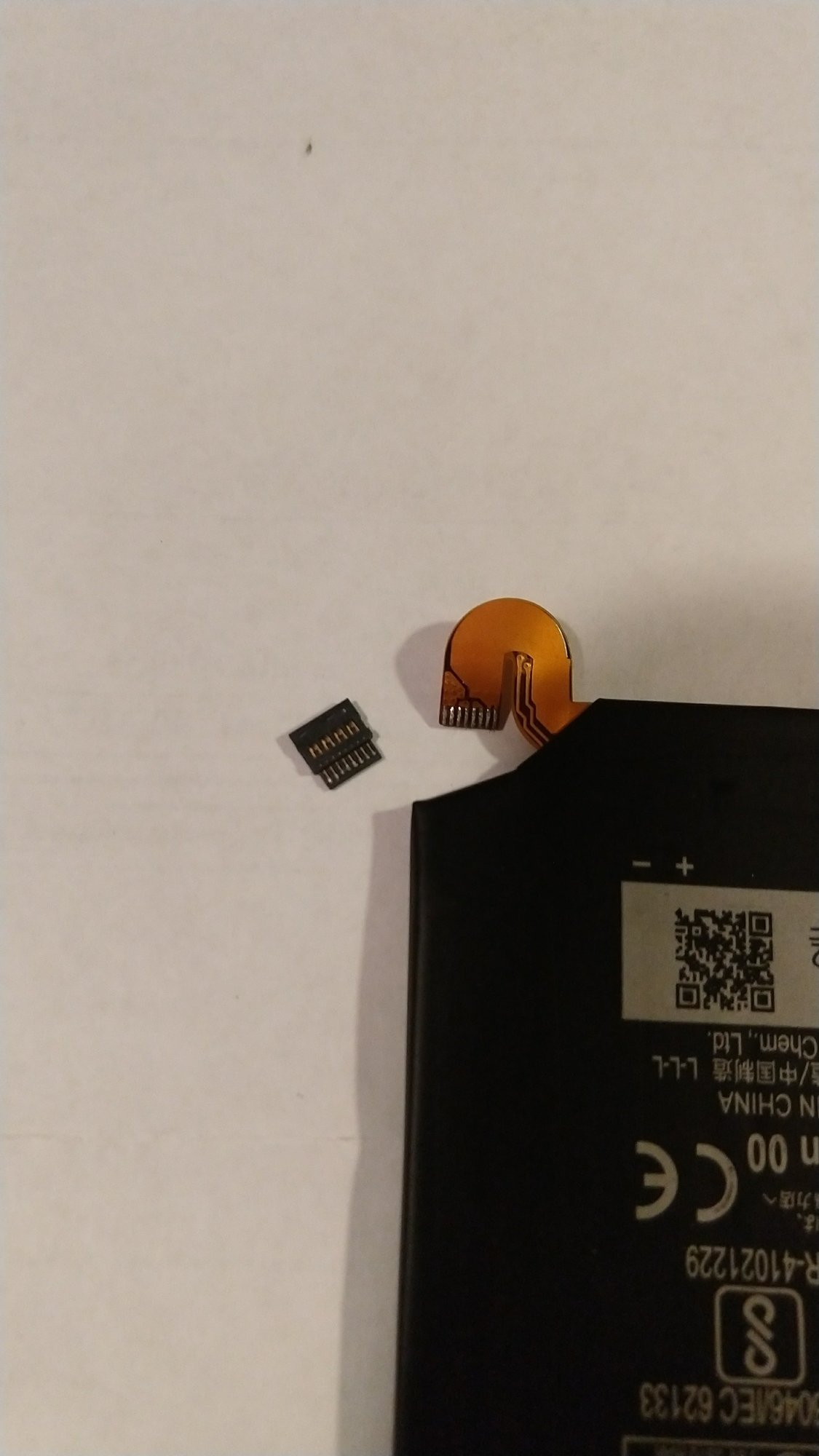

I'm still waiting on eBay replacement since the connector popped off the ribbon cable on the one I received Friday

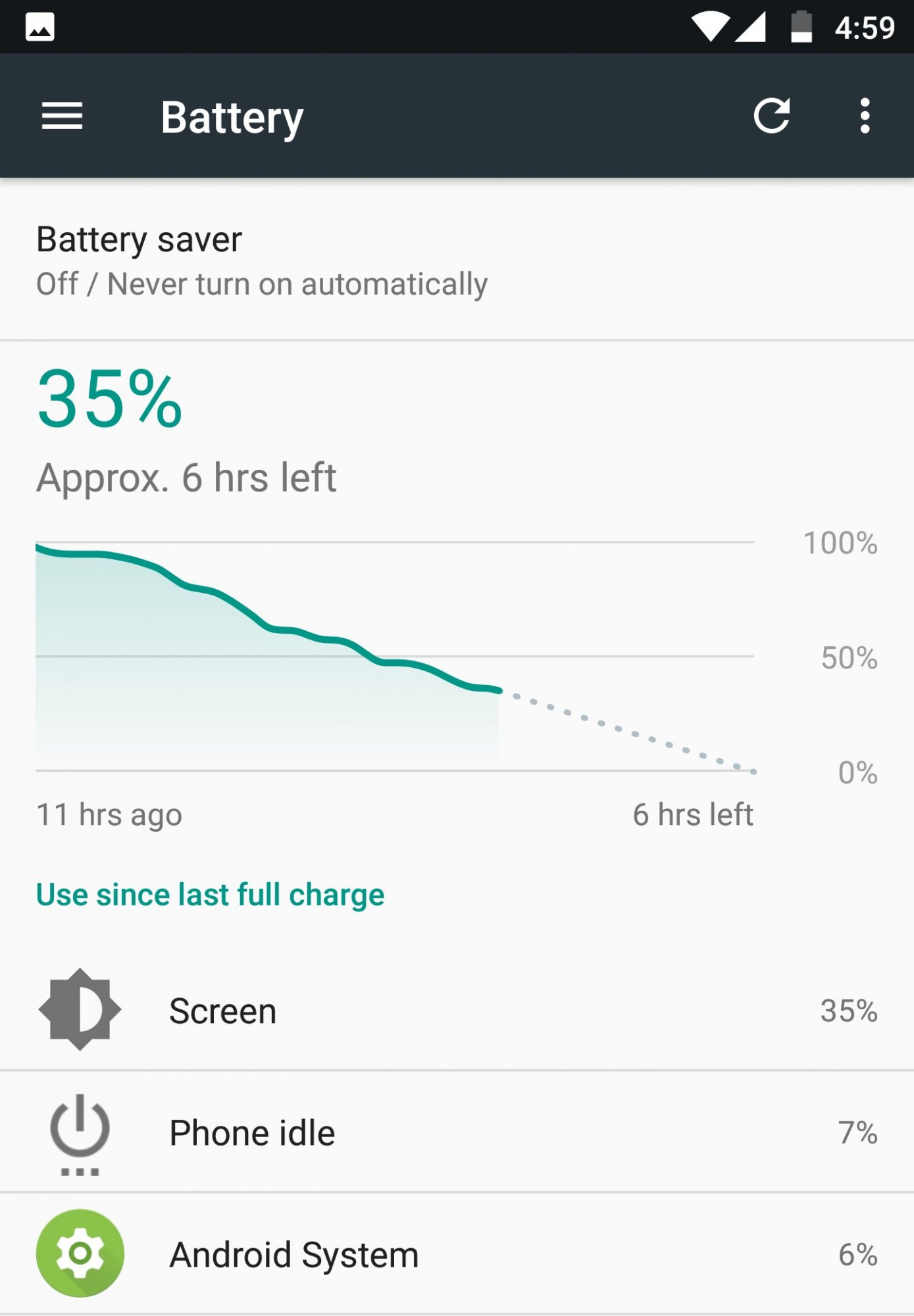

Here is the skinny on the replacement battery. Streaming, web and standby. Better than I expected it to be. A little over 4hrs SOT.
This is a phone that I picked up from the Boneyard at Swappa that was Google locked when I got it. Can't really remember how the battery life was like on the original MXP that I bought new but this is pretty close to what I'm getting on my new X4.

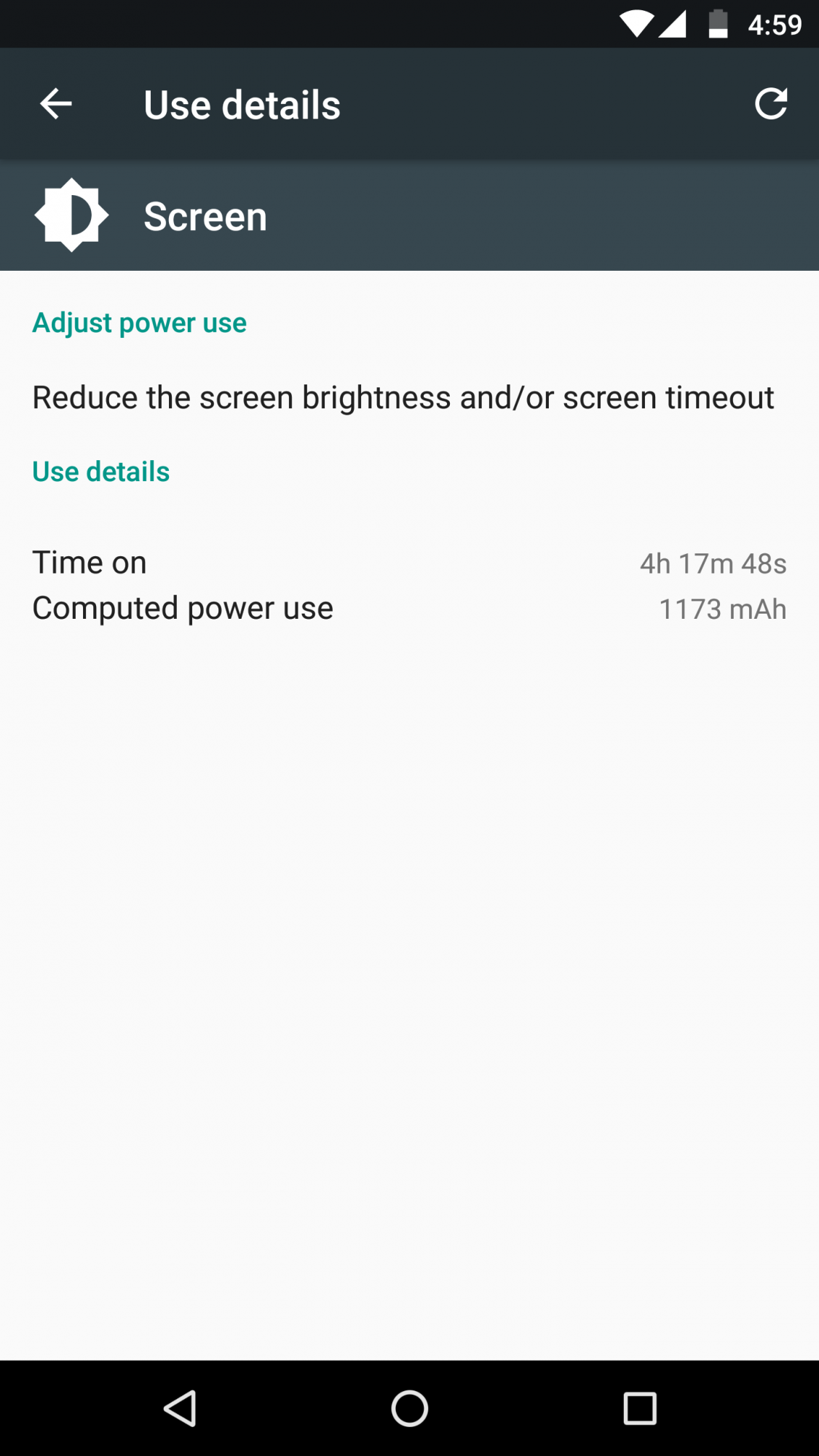

Depends on what you do with it. Screenshot above is with a lot of use over 11hrs and over 4hrs SOT.
Yesterday, hardly used much at all and had 75% left after 16hrs. Big improvement over the original battery.
Everyone uses their device differently so results will be different.

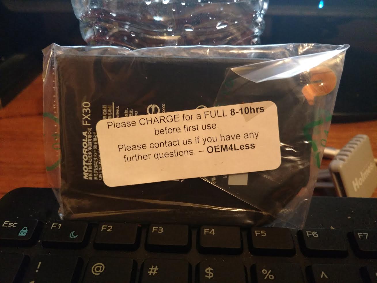

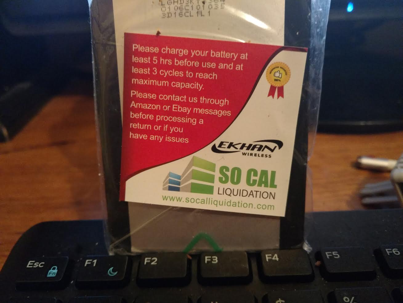

Just got the new battery. Except there is one set of instructions on one side and another on the other of the plastic wrapping package.
Can someone help me decipher this. And when it says "Charge for 5 hours and 3 cycles" exactly what do they mean?

Just fully charge it... 8 hours is probably overkill. And don't expect to see full battery life for 3 full charge cycles.
Batteries are not as finicky as they used to be, just put it in and use it. But my guess is, Company A got these originally, and company B bought their inventory and is selling them now, they have different guidelines.
Looks like you found the original OEM battery. All the replacement batteries I have found where not the original, bare aluminum on the back and Motorola stamped on the front. Both replacement batteries I've used where not as long as the original and one not as wide.
Looks like you have the real deal.
