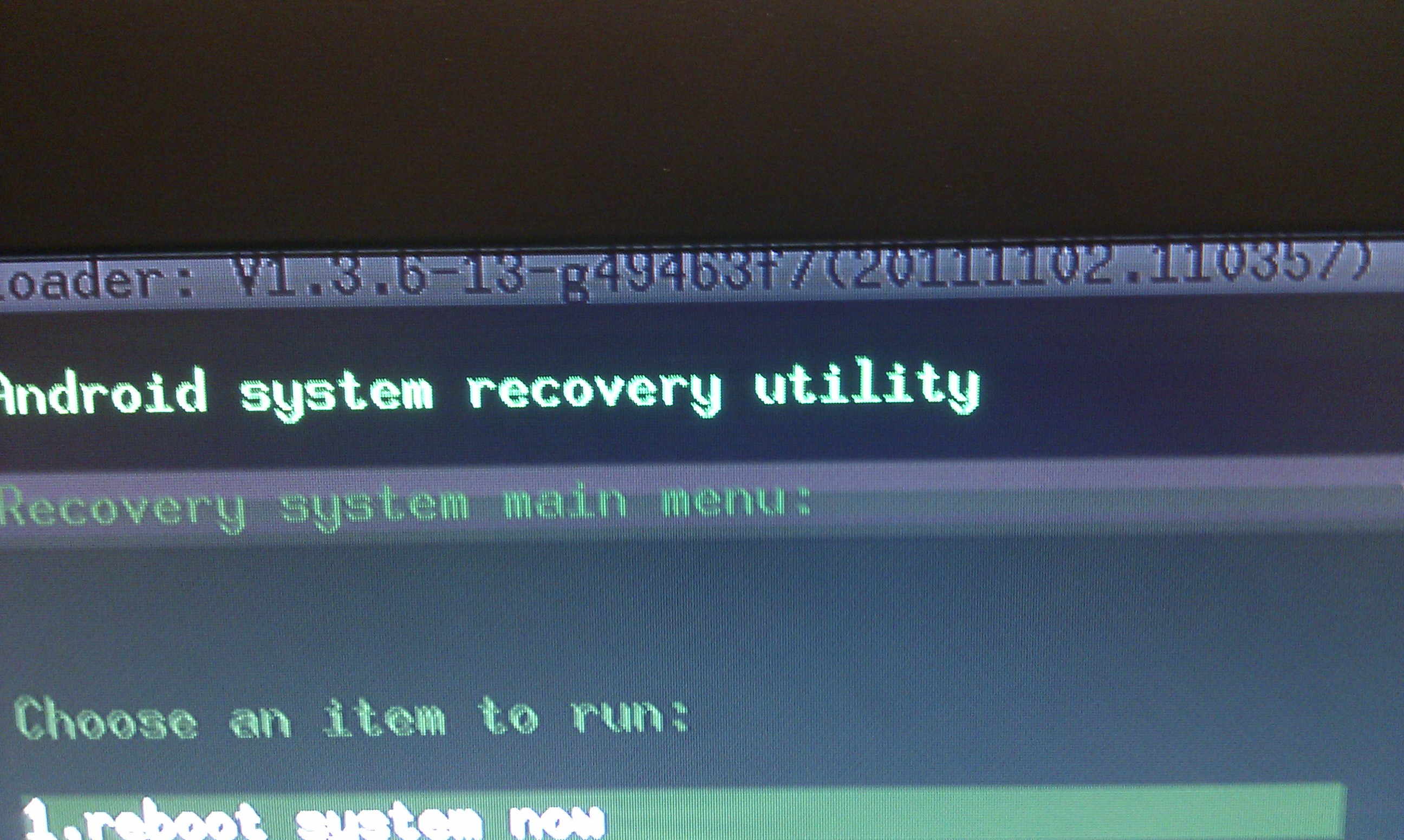

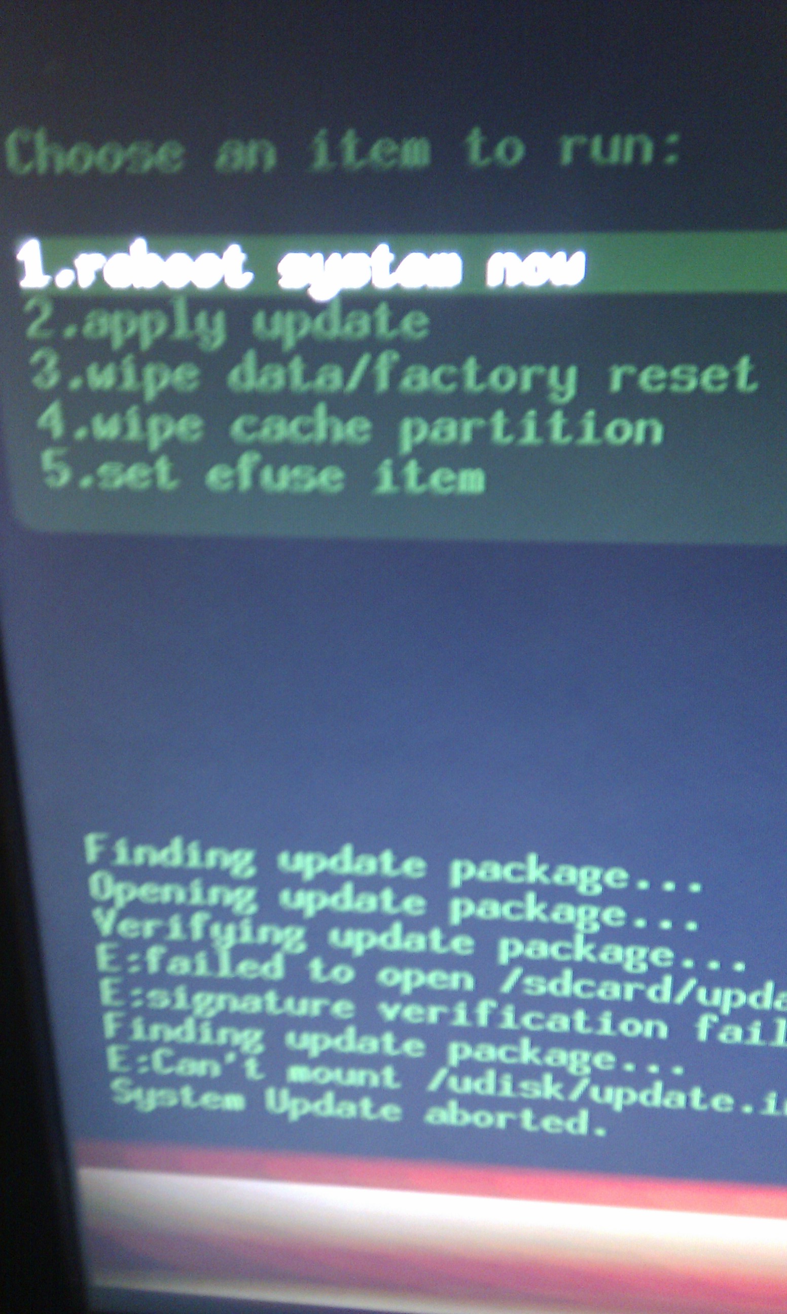

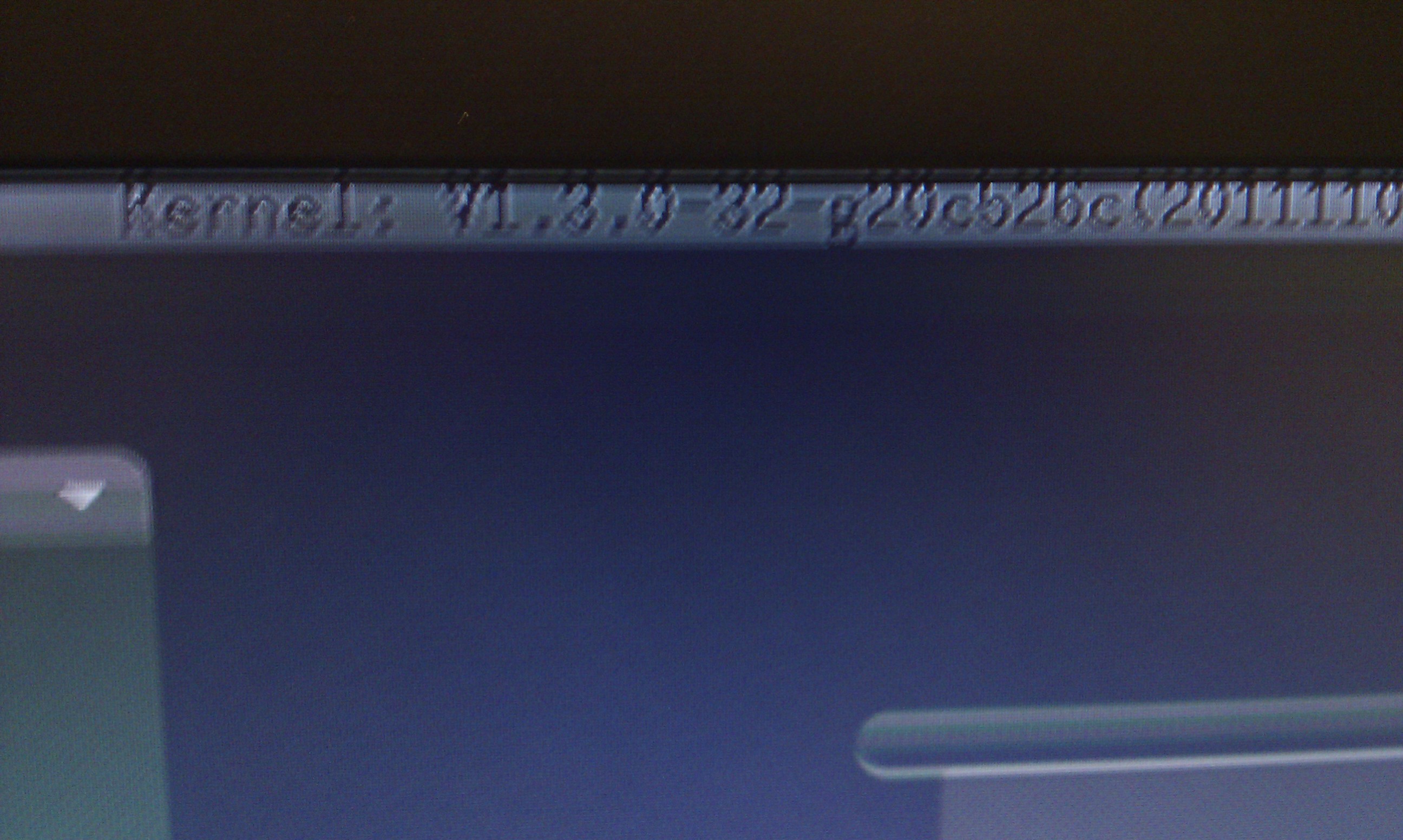

I have uploaded some screenshots of the error message.
Scratch all that. Seems to be working. Thank you. It was the hidden files extension. Thought I had done it correctly, It was not until I watched the you tube video that I realised I had not. Anyway, only took me about 7 hours! :mad:
