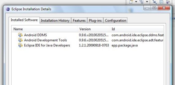

I'm following the instructions on installing the Android SDK and ADT from the ebook "Hello, Android" by Ed Burnette. Everything seems to have gone fine up until the point where I select "File -> New -> Project".
Attachment "sdk.jpg" shows which packages are installed.
Attachment "eclipse1.jpg" is "Help -> Install new software" in eclipse.
Attachment "eclipse2.jpg" is "What is already installed" from the previous window.
My impression is that everything is installed correctly. If I reload Eclipse now and select "File -> New -> Project" android doesn't appear amongst the options. Also if I go to "Window -> Preferences" there is no mention of android.

It looks to me like Eclipse is not downloading/installing everything it needs for ADT. It states that there are no new updates for ADT however there is no mention of Android amongst any of the preference settings (which to me would suggest that ADT is not installed).

The Android option is not coming up under Windows>Preferences in Eclipse after installing the ADT?
One reason that this may be occurring is because of Windows 7 security settings. Try starting up Eclipse with​
...thanks to Nameless931, *running Eclipse as Administrator fixes the problem*.
Also, for the sake of completeness, I resolved a couple of other problems by putting eclipse and the SDK in a path with no spaces (originally, foolishly, put them in "Program Files").
