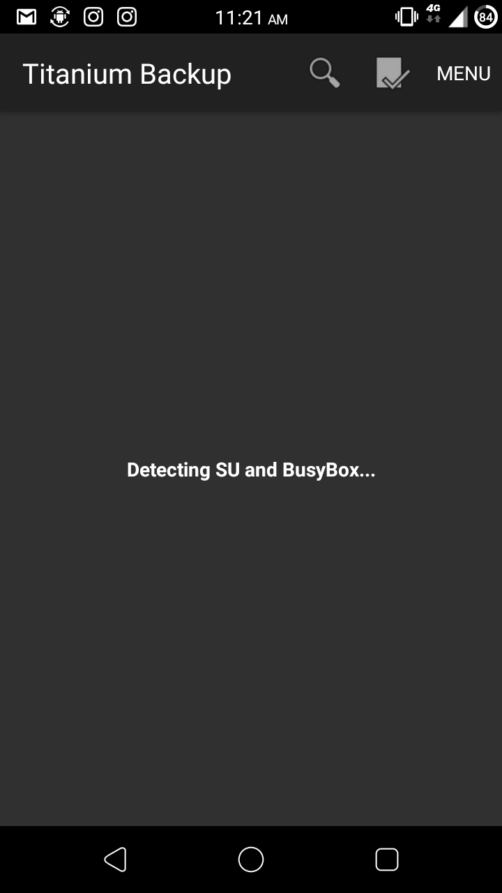

Hey everyone i havent been that active in the Stylo section but i jist have a question. I wanted to downgrade from 6.0 to 5.1 katana rom. I recently rooted my ms631 running 6.0 and it sucks, i cant use things like titanium backup or rootcloak. I just believe its time for me to go back.

Why can't you use Titanium backup? I'm using it fine.
RootCloak is hit or miss on some apps, what specifically is the issue there?
It never asked me for root permissions, i have looked up several ways to fix it but nothing works
I'm going to assume you unlocked bootloader and have TWRP installed?
Did you use the ADB method to root? That included flashing SuperSU.
If you used kingroot, you need to flash SuperSU
EDIT: Did you install the Busybox app?
Yeah i have everything else including busybox an i have flashed supersu already, bootloader is unlocked and twrp is installed. Maybe its just a random thing
Uninstall and reinstall TiBu and then reboot phone. Also use root checker to make sure you have root

dosent work ... lol thanks for helping tho gonna restore
