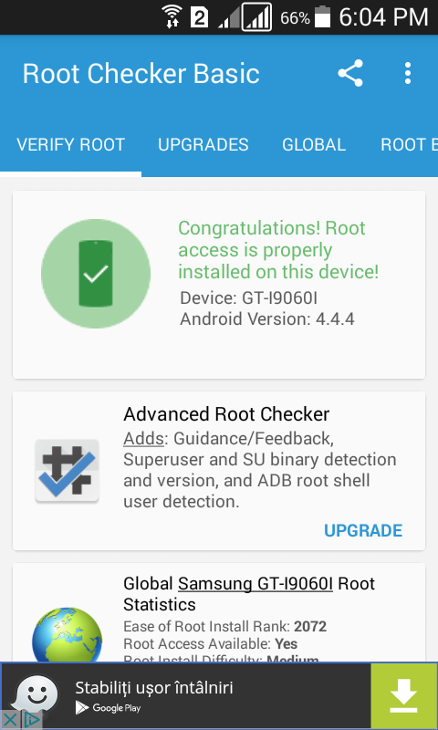

I've had some hard time trying to unlock my GT-I9060I's bootloader (so I can install unsigned custom ROMs) but I didn't succeed.
Thins I've tried so far:
  • Installed Android SDK
  • Installed ADB and Fastboot drivers
  • Changed the android driver to Android Bootloader Interface
The problem seems to either be my computer not recognizing the phone in fastboot mode or simply my phone not booting in fastboot mode (even though
HTML:
adb reboot bootloader
rebooted my phone)
How can I unlock my bootloader?

Ok, Root Checker says my device is rooted. If my booloader is unlocked that means I can install a custom recovery?
Yes. Being rooted requires bootloader to be unlocked, which is what we did by installing the .md5 file.
