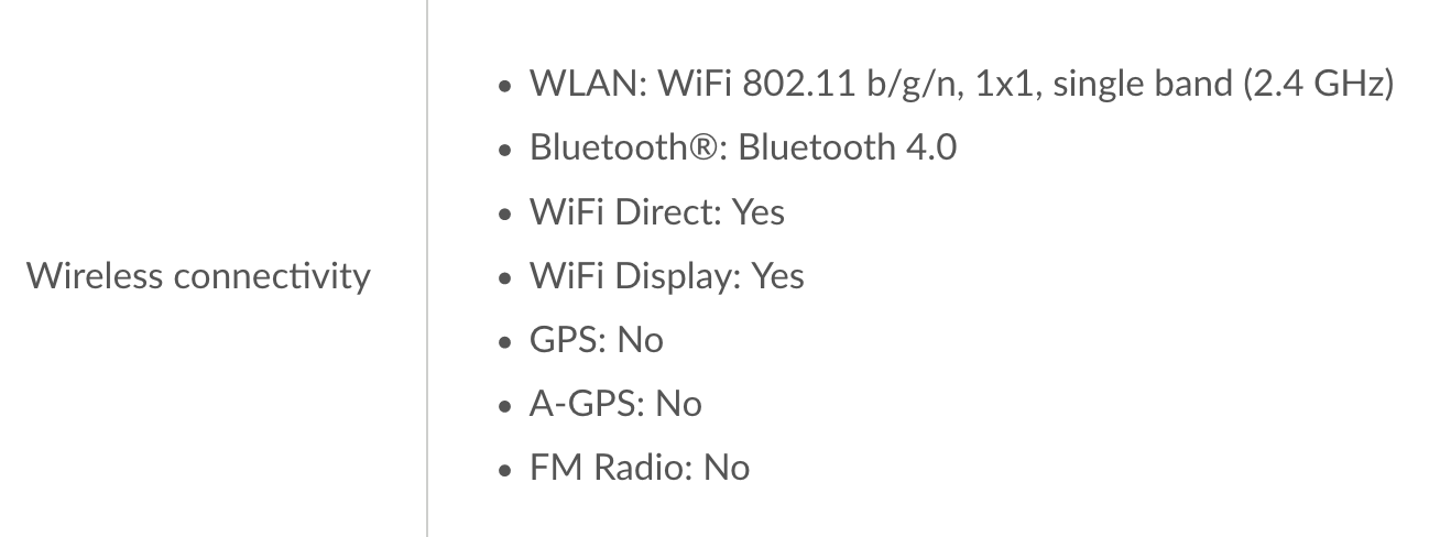

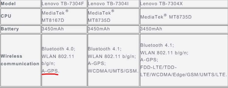

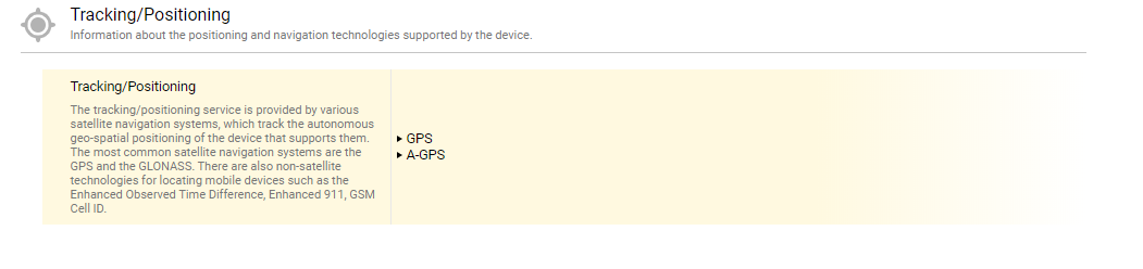

Actually are you certain this tablet has GPS? I've found various sources that say it has, but the one link I found from Lenovo themselves say it has not.
It is of course possible that there is more than one model called "Lenovo Tab E7" - Lenovo would hardly be unique in doing that. But if it doesn't have a GPS receiver then the low power (wireless network) location would be the only option.
So the question is, who do you trust: that site or Lenovo themselves?

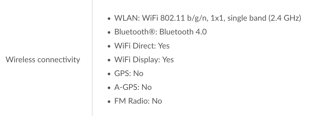

Lenovo have another site for looking up the details of particular models, e.g. national variants. You can find it here: https://psref.lenovo.com/Product/Lenovo Tablets/Tab_E7. I looked up a couple of UK E7 models there and found no mention of GPS in their specs.
Of course the real test would be if you have a manual or spec sheet that came with the device.
I think there's at least two variants of the Tab E7. A WiFi only one that doesn't have GPS, and one with cellular data using a SIM that may have GPS. And it sounds very much like you have the former, without GPS, which would certainly go with what you've been describing.
yup true my model is https://psref.lenovo.com/Detail/Lenovo Tablets/Tab_E7?M=ZA400010GB and it seems like there is no mention in GPS
