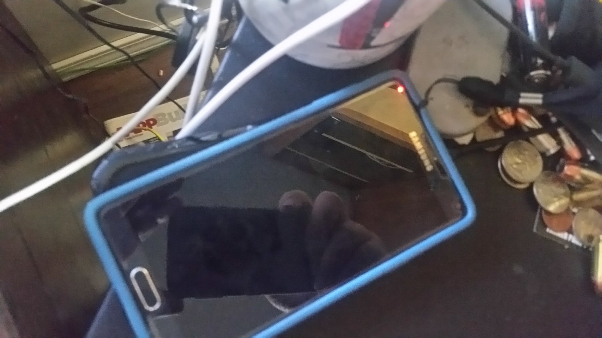

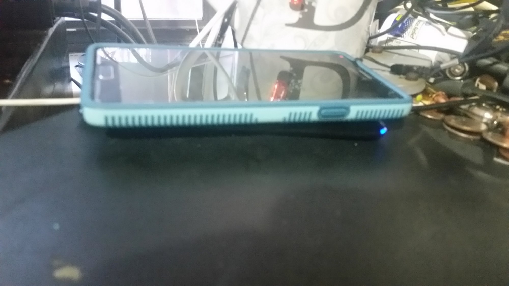

I have an update, the problem with my Note 4 and Qi charging was the "Placement" of the phone on the Qi pad.
I did not originally think about the fact that the location of the Qi receiver coil is NOT in the center of the phone, it is to the Left Side of the phone as viewed from the front.
It is now charging just fine on the Qi pad that I have used for the S5s in the past.
Here is a pix of me "discovering" that it was "off center" previously when I just casually dropped the phone on the table and it "just happened" to land across the Qi pad at an angle... A Blue Light? wow, it is charging, leave it alone!!!
