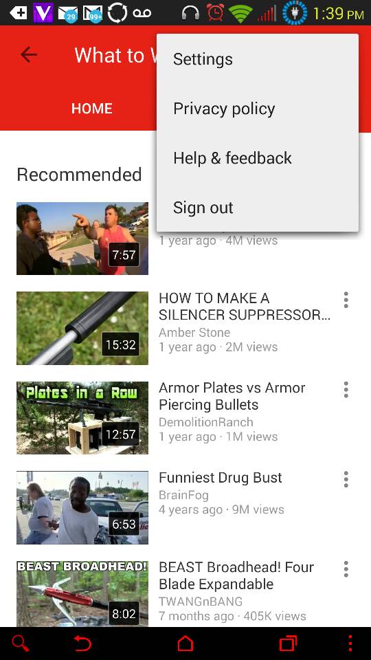

NOT the menu to the left.
Three dots, UPPER RIGHT, when not watching a video - tap it.
Notification button is right there.
3 dots, upper right corner when not looking at a video.

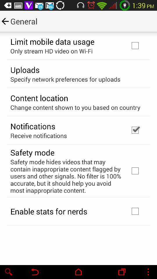

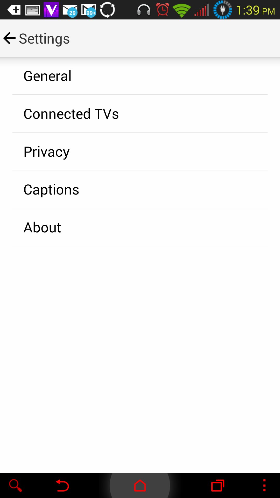

I do not have the three dots in the upper-right. When I open Youtube, it brings up a list of videos that are recommended to watch. Clicking in the top-left gives me "What to Watch", "My Subs", "Uploads", etc. There is no settings.
However, I know of a function button on my phone that brings up settings. It looks like the first screen in the menu options, at least. I didn't have a sub-click to General, I just got to turn off notifications, which were on for some reason. I also turned off "Improve Youtube".

3. The settings to receive content notifications? They keep resetting. Which I think is illegal (if I say I don't want content notifications, don't f*ing force me to receive them), but somehow it happens. Sending feedback to Youtube is also turned back on automatically.
