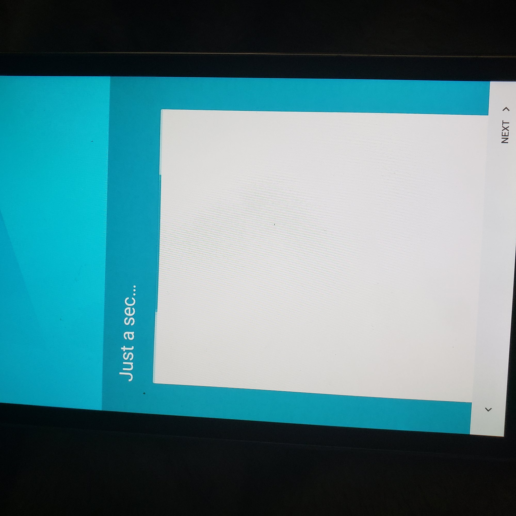

So i have a Galsxy tab4.. I jail broke it and got kingroot.. I noticed my play store wasnt working and stuff so i went to factory reset and everything got worse.. After factory reset it would get stuck on connecting to wifi.. So i ended up turning off wifi to see will i surpass it.. But now it just stays stuck on the "just a sec" screen.. Does anyone know how i can fix it?

Hi @Daan192 , welcome to Android forums. First off, you "jailbreak" Apple devices. With android it's called rooting. Once you rooted your Tab4, any changed made to the system become permanent and survive a factory reset. What you will probably have to do now is flash the factory firmware to restore it to it's un-rooted condition. What's the exact model number so we can track down the correct way to do that.

That seems to be an international version of the Tab 4 so you have a lot of options when it comes to country and language. You can get the latest factory firmware here: https://www.sammobile.com/firmwares/galaxy-tab4/SM-T330/
The tutorial on how to do it is here: https://forum.xda-developers.com/tab-4/general/guide-how-to-restore-stock-firmware-t2979006
That's a pretty basic explanation but it should be good enough. Take a read through and let me know if you have any questions or concerns.
