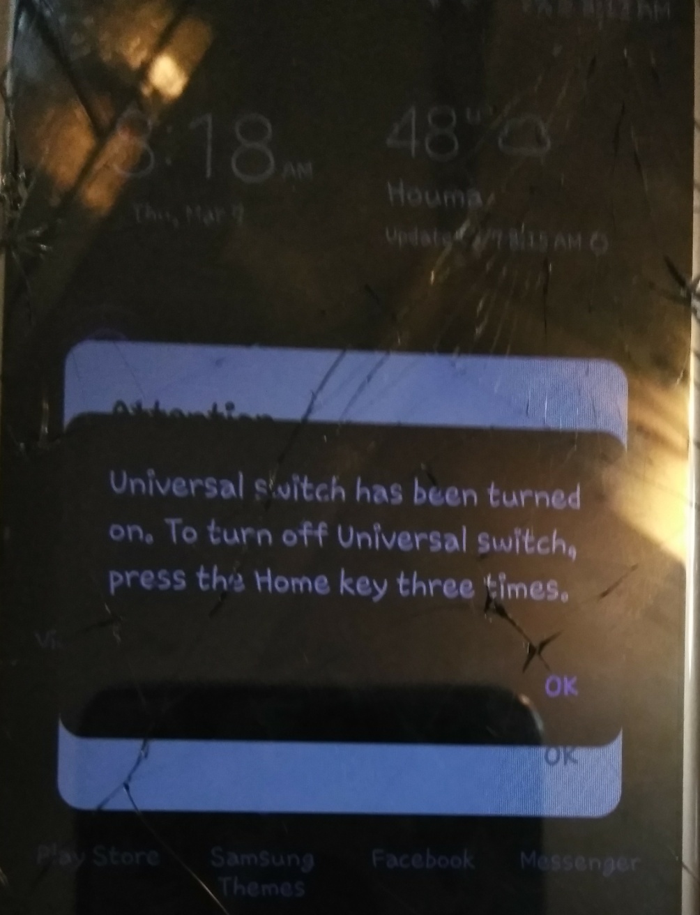

How can I factory reset a Samsung j-3 with a broken home button
Holleym
Be home button on my Samsung j-3 is broken and I can't do much of anything because there's a universal switch ision the screen is also broken so that's giving me trouble can anyone help
samsung-download-mode-jig
put into download mode with jig
after that flash csc file
with odin tool
You might try an OTG USB adapter that let's you plug a mouse into your phone and control it that way. Since the phone boots otherwise, you should be able to get to the settings menu to reset the phone.
What is the universal switch on your Samsung?
Anyway try the OTG mouse as the above post suggests.
