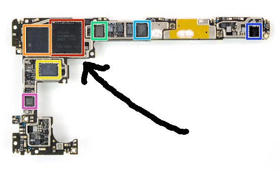

Smartphone RAM is soldered onto the logic board itself so this isn't something that is readily upgraded. It's for the most part a fixed amount, as is.
Just for a visual detail (taken from https://www.ifixit.com/Teardown/Huawei+Mate+30+Pro+Teardown/127743 step 10), here's the logic board from a Mate30 so this isn't exactly the same as what's inside your phone but a very close representation:
The 8GB RAM chip being highlighted in red. The internal components are not in sockets or modular so replacing/upgrading them just isn't practical. If you really need more RAM in your phone, you need to buy a different phone.
