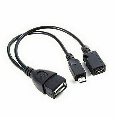

for external harddisk you have otg cable with a 3rd plug for a powersource.
this powersource normally is there only for the ext harddisk and not for the mobile.
