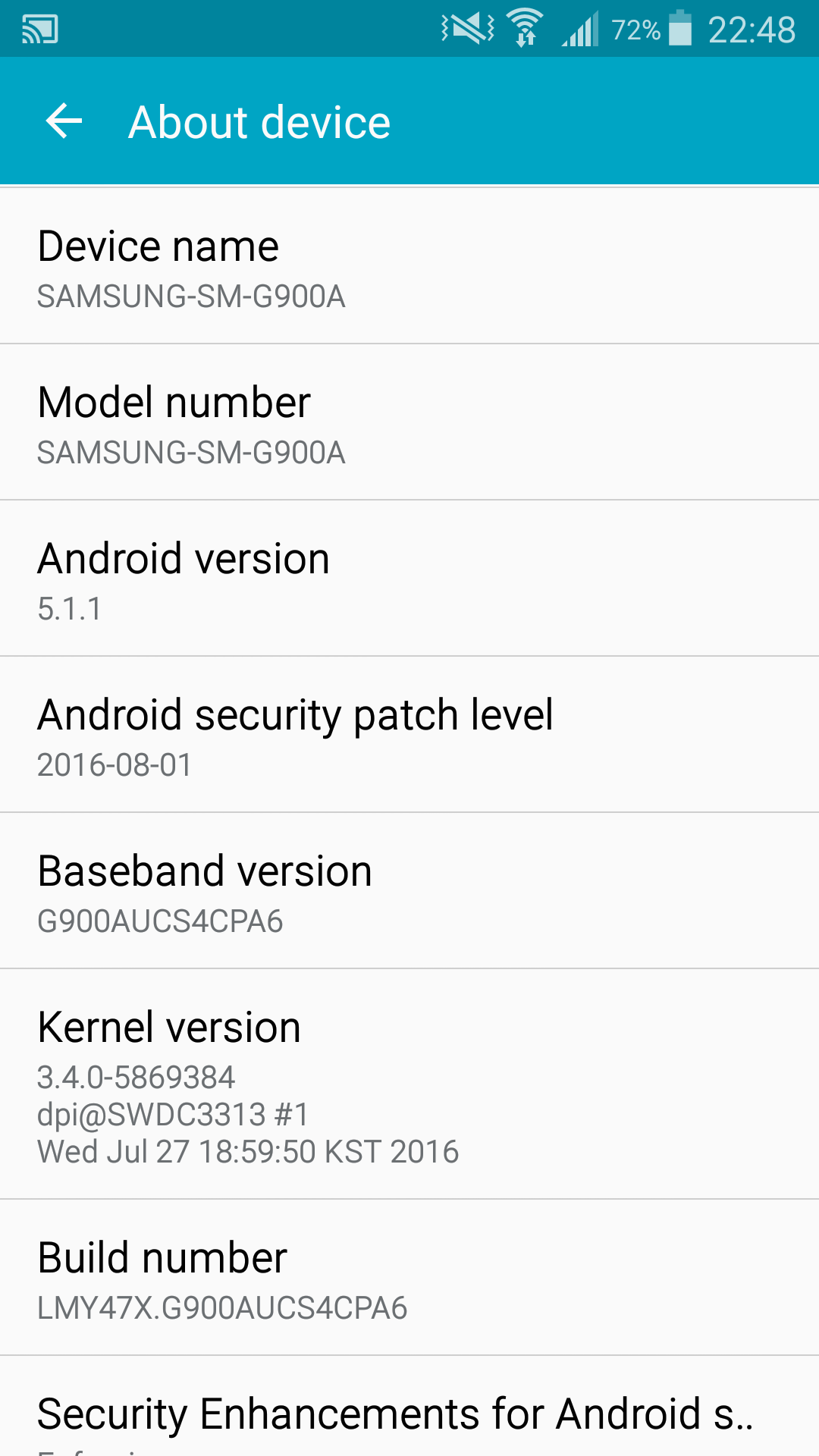

Yeah, I read that, this is ph current info
AT&T doesn't like to release it's firmware and you need a active AT&T Sim to receive OTA updates.
Have a look at this thread at XDA. It has AT&T firmware that will let you upgrade to 6.0
https://forum.xda-developers.com/att-galaxy-s5/general/g900aucs4dqd1-odin-update-v6-0-1-t3603897
Yeah I downloaded the right 1 from that xda thread and extracted the folder but then I got stuck because I extracted from the next folder and there were these 4 strange files that when I clicked on them I wasn't sure what to do, so I researched a little just briefly and it was mentioning stuff about rooting the phone and some things about odin etc, I got stuck so I just left it lol
What they have in the link is the 4 part service files. You would need to put each part in it's individual slot in Odin to flash.
These should be pure stock.
